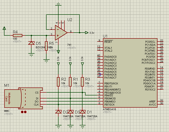

Hi, everyone,
I have learnt alot about SD card interfacing and i am able to save and extract data from an SD card(in simulation).
After several attempts I am also able to run it in hardware environment, but my issue is just not simple because although it runs on hardware now, it detects SD card sometimes while does not detect SD card sometime, even it is also detecting while no SD card is attached minorly :/.
Can any one help me solving this strange and "ghostia" issue? (Keeping in mind, that I am able to run it in simulation successfully but not in Hardware)

i think there is interfacing and spi clock timing issue.
post your circuit image.

Why don't you use a known working level translation circuit?
I have used various know level translator circuit but what I am using now give me the better result over them.
Regards:smile:
I would consist on:
- 5 to 3.3V voltage divider or driver ICs instead of shorting the outputs of a 5V provessor with a 3.3V Z-diode
- 3.3 to 5V level translator for DO
- pullup resistors for unconnected SD card signal pins
- in case your software has difficulties to distinguish a floating DO signal from a reasonable card output, a pullup on DO as well
- a 3.3V supply for the card with sufficient bypassing. As it's not shown in schematic, we can only guess about the point. Supplying the card from a 741 output would be "not so good", I assume
Nevertheless, the problems may be software related as well.
FvM,
Kindly tell which values I should use to get a 2:3 so that I does not limit the speed of SPI communication?
I mostly used 74LVC gates as level converter, (inputs can be overdriven to 5V), but an 1.2k to 2.4k voltage divider performed well in a test. ATmega SPI speed is limited to moderate 8 MHz anyway.
Thanks,
Can you please tell me that what is a better circuit for the implementation of 3.3v to 5v translation?
Regards.
According to specification, the ATmega input voltage range (Vih >= 0.6 Vcc) is still compatible with 3.3 V logic output, but with a very low margin. I prefer 74HCT gates (TTL input level specification) as 3.3 to 5V CMOS level translater.

I think the card I am testing in simulation is an image file of MMC, but the card I am testing in hardware is an SD Card, I have triple checked all of my connection and they are giving outputs as wished.

I've been also asking about the card supply voltage. Can we be sure that it doesn't bring up the issues?
I am now cent % sure that it is not an issue of hardware, but of my software. The software is detecting MMC but I can't simulate an SD card on proteus and the main issue is in the code for SD version.

Atlast, got it working now, the problem was with the command sending function.
Thanks FvM, for your great help.
