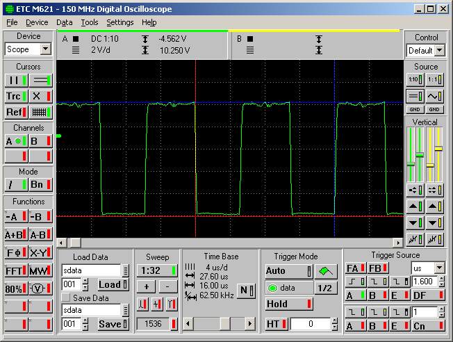

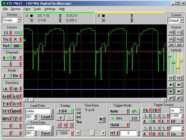

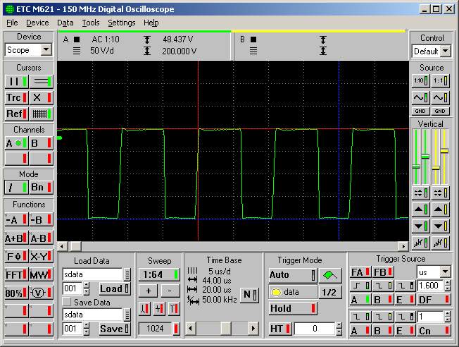

Hello, after some time......
I changed C625 and C646 but nothing happend. the same problem.
I measured waveforms (3,4,5,7 according to the manual) they seem to be ok.
You can look at them:
http://www.plsanek.szm.sk/3.jpg
http://www.plsanek.szm.sk/4.jpg
http://www.plsanek.szm.sk/5.jpg
http://www.plsanek.szm.sk/7.jpg
Does the voltage +14V have to be exactly 14V? it's 13.6V (the ripple is about 0.2V)
The volatage 210V is about 206V the ripple is small too.
Is It still problem in the reg. circuit?
Thanks for help...
