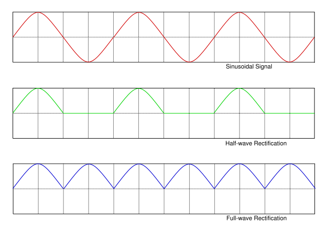

The ripples frequency is either 50hz or 60hz?
Ripple on a full wave rectified supply is 2x the mains frequency
Full wave rectified supply 60hz X 2 = ripple frequency is 120hz?
For 60Hz after full wave rectifier it is 120Hz ...
For 50Hz .....................100Hz ...

consider line frequency to be 50Hz, when u apply full wave rectification, the o/p is half sine positive side ripples which is periodic in nature and at frequency 100Hz i.e. 50x2.
Considering the o/p of rectifier just contains one single big capacitor, the o/p will have the same 100Hz ripples.
