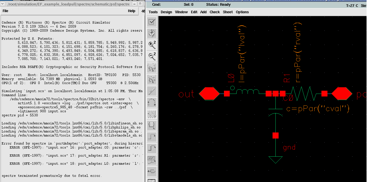

Greetings everyone,
I'm trying to simulate a power amplifier and find the load-pull contours. I've done the state setup and the design set up as the spectreRF manual says. The thing is, spectre can't seem to understand the portAdapter symbol. When trying to simulate the design, I get an error as shown in the picture below. The parameters that are presumably unknown are the portAdapter R L and C parameters. Does anyone have any clue to why this error occurs and how to solve it?
Thanks for your time!
Aleksandr
My guess is that the problem lies within Parameterized Cells. I tried to add the lval, rval and cval parameters to the schematic in the CIW-tools-CDF, but nothing changed...
