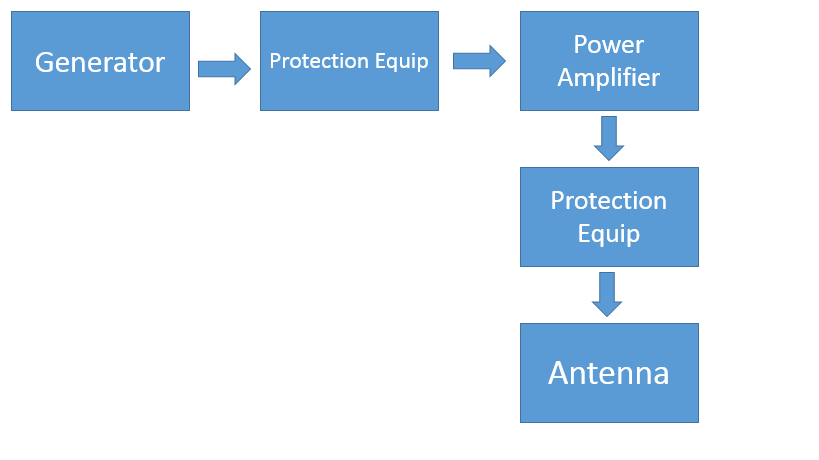

hi to all...
i am generating a modulated signal and want to transmit the signal through Power amplifier. i want help regarding the reverse power protection and other parameters which can damage my generating side or power amplifiers....
I need all the protection possibilities for my generators, power amplifiers and antenna because all the much costly
I think the first protection circuit is not ncessary because power level which is delivered to PA will be relatively low and the input impedance of the PA is more or less matched.The generator output is-probably- self protected against such low power reflections and tolerated. For output, you may use "Ferrite Circulator" depending on the frequency and power level.But note that, it's not possible to find a circulator for every frequency and power levels.

@BigBoss
Turning on the power amplifier without Antenna reverse all the power to its input. i am using nearly 30W to 100W. if this all power reflect on the input of the PA, its guarantee that generating side will burn easily
If full reflection occurs, the amplifier will be burned first so don't worry about input side.
Since you use a circulator at the output, no full reflection will be occured toward to the amplifier.In additional to this, there is amplifier reverse isolation about 20-25dB.
The essential is to use a convenient circulator at the output who will absorbe reflected waves on it self.

after the amplifier, i will use circulator. can u suggest me anyone. i have not much time to develop a circulator. can you tell me any place from where i can buy it.
secondly lets make it exception that if PA reflect the whole power in its input, then the generator will definitely burn. for the sake of protection, advise something.

I said it before, if there is a circulator at the output no full reflection will be occured.
Circulators are very special components and they are unidirectional ( ideally).There isn't any other passive unidirectional components than the circulators.
You can find many manufacturers and distributors but it's worth to look at this..

do you not understand what people have been telling you ?
what do you think you are protecting the generator from ? .... its own output power ?
what is the output power of the generator into the amplifier ?
