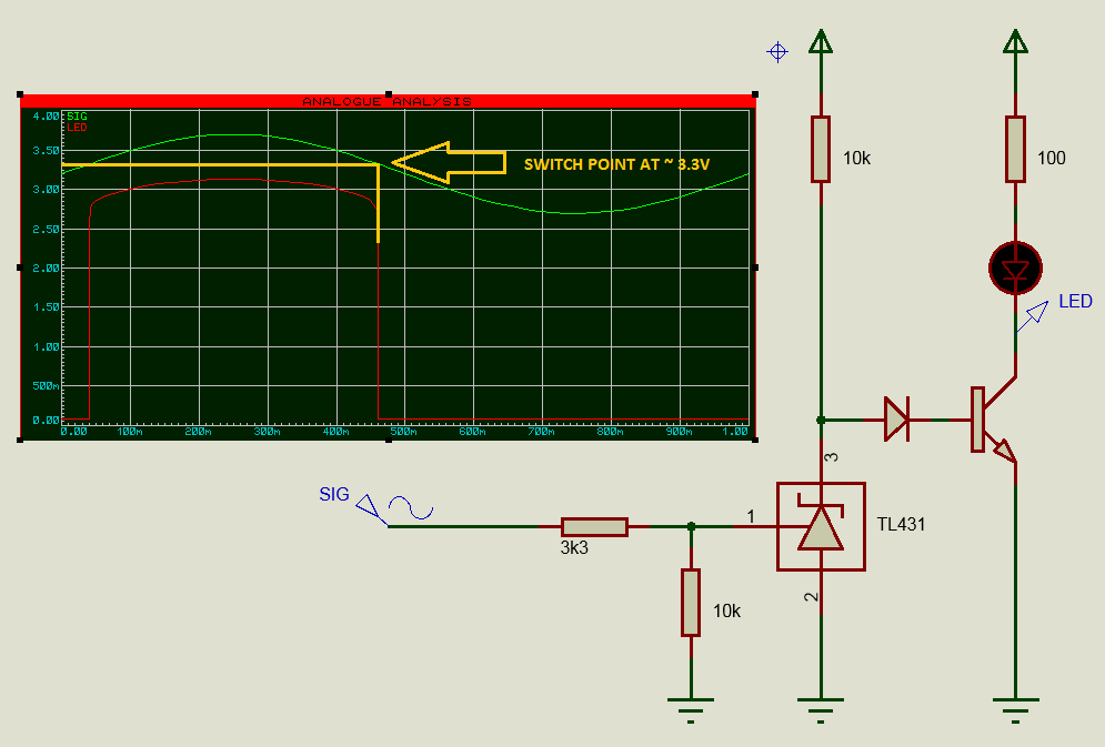

I choosed 3.3 because of expected voltage drop on battery because of load. 3.2v - discharged unloaded battery. Anyway, this schematic can cause led flashing because of low histeresys value.
We could give it some hysteresis by fitting a high value resistor between the collector of the transistor and the input to the TL431.

Like this?

It should definitely work if all the parts are good and it's properly connected up.
no... the led doesn't gets off at any voltage... i have also tried using 7.4v supply.... but still the led stays on even at 7.4v.... have also tried replacing. the components and checked my circuit 3 times....
Do you know what for I used that diode? Show me exact that schematic you used.
