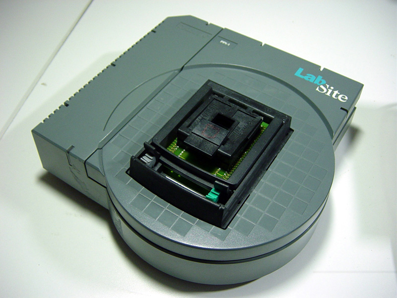

I acquired a DATA I/O "LabSite" Universal Programmer with the 84Pin CPLD adapter off eBay. I then eventually found the matching software for this module after months of pain staking research and searching through Forums. Unit is Shown Below:

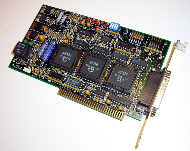

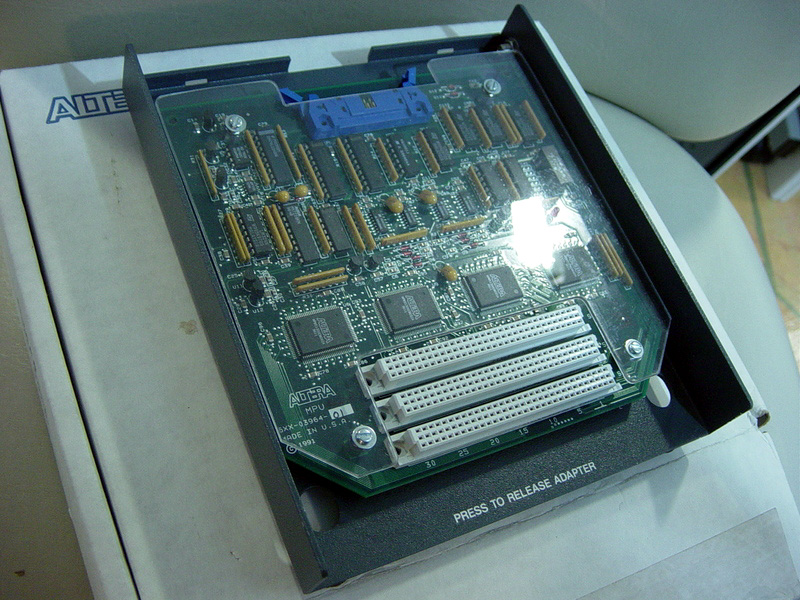

And now just recently, I acquired the Altera LP6 "Logic Programming card" for the vintage Altera PL-ASAP2 MPU setup. This package contains an Adapter Base that accommodates various Chip socket adapters. This MPU Base interfaces to the LP6 ISA card via a DB25 Pin Ribbon cable and programs your chip of choice using the Altera MAXPLUS2 Stand Alone Programmer software.
The Altera MPU Base.

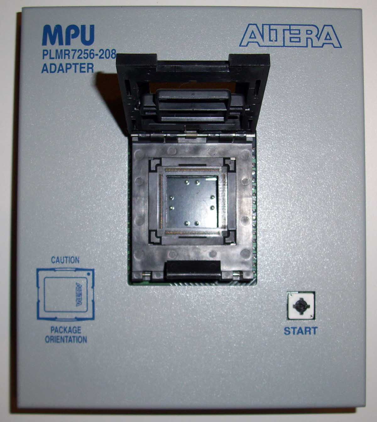

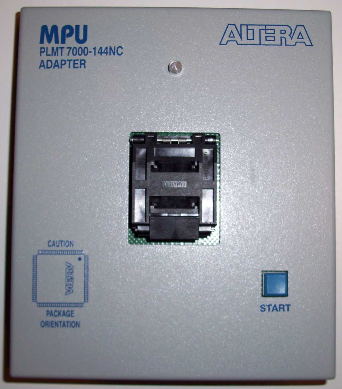

Below are a couple of the Adapters I have acquired:

This is a common problem many student/hobbyists encounter when they buy second hand Chips off the net like Ebay. The chips are useless as far as JTAG
programming goes. The only way to have the JTAG communication lines restored is to use a NON-JTAG programmer Like the Altera Master Programming unit or a third party programmer like the DATA I/O Labsite or Unisite. Using these programmers to erase the chips or perform a Blank-Check function, reconnects and enables the JTAG communication port just as they are when you first purchase the chips new.
This particular mode for the Altera chips is called "JTAG LOCKOUT". and is just a real pain in the butt.
