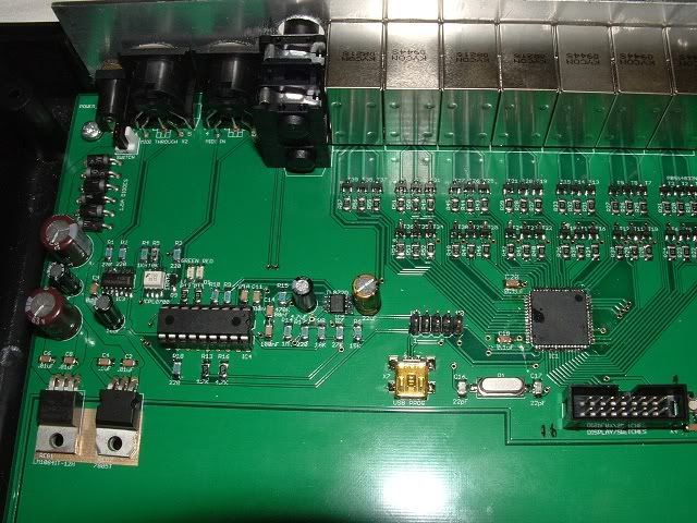

I have a question concerning this THIS SCHEMATIC that I designed. I built a prototype with out some of the peripherals just for test purposes. The guy that is programming it is having issues getting the **broken link removed** to talk to the chip. Could someone possibly look over the ISP and Atmega128 portion of my schematic to see if maybe I made a mistake in my design? Any advice would be greatly appreciated. (I used the footprint from an atmega103 to draw the schematic, but the pinout is the same). I wonder if it has to do with the RESET or PEN pins not being pulled high?
Here is a photo of the board:

I didn't notice the link. The ISP schematic seems fine, except for the missing nRESET pull-up resistor. You should also care, that the MOSI line isn't pulled down through the MIDI interface. Finally, there's a certain risk, that the ATmega CKSEL fuses have been unintentionally set to a wrong mode.
Thanks for the advice. I think I may have found the problem. When looking over my PCB, I notice that pin 53 (gnd) was not connected to the ground plane. I will fix that first and then if that doesn't do it, I will try the other stuff. I am thinking that that should do it though.

We are still searching for the answer. Fixing the ground on pin 53 didn't do it. I was hoping that PEN was the answer, but after what you said FvM I am afraid we are back to square 1. Not sure where to go from here. I guess we can try a pull-up on reset and see if that does it.
Did you program the specific chip before or is this the first time?
Have you tried the programmer before or with another chip to verify its operation?
What is the value or resistor R21 connected from the sck to the base of the transistor, is it 100 ohm like R19?
Have you checked the soldering of 128 for any shortcircuits (i see some fat solder joints but i don't know if it is just the photo) or have you used any liquid soldiering paste that needs to be cleaned?

1. This is the first time we are trying to program this brand new chip.
2. Yes, I programmed one other chip with it and it seemed to function properly
3. yes all of those resistors are 100 ohm
4. Yes, I checked all of them with a continuity tester and they checked out OK. (I have shipped the board to my programmer, but I will have him recheck it again)
5. I used the 100 ohm just so as not to have a short when the transistor had power to it. What do you suggest, and why will I have a problem with it if you don't mind my asking? The **broken link removed** shows a base current of 1/2 amp for these transistors.
6. Current for MD outputs is about 500ma for each set of 3. So basically 200ma (maximum) per transistor or thereabouts.
Will the resistor value (R21) on T2 be a problem for that particular pin? Right now there is nothing on the MD outputs (they terminate to a jack), so the transistors are at an idle stage.
Thanks for taking the time to look this over. I have learned everything I know from Google so please bear with me if my knowledge is not up to par!
When you give a voltage to the base of the transistor, there will be a base-emitter current even if you don't have anything connected to the collector, think of the base emitter as a diode, you are giving 5v to the anode of the diode through a 100 ohm resistor and the cathode is connected to the gnd.
I think this resistor is definitely the problem because i doubt that the programmer can supply that current so it can't send the clock pulses, when the programmer is trying to send the clock pulses to the 128 it also drives (opens/closes) the transistor.
I said you have a problem because the 128 can't give that much current, if you open the 128 datasheet at page 318 (absolute maximum ratings) it says DC per I/O 40ma and VCC current 200-400ma.
All the current of the pins summed should not go above that VCC limit and you are already working near if not over the absoluter max current for the I/O pin.

Alexan_e has actually recovered a serious design fault. It's manadatory to keep the VCC pins maximum rating.
It does however not explain the programming failure, because all outputs are tri-stated by default, and even if the chip has been programmed before with a code enabling the outputs (which could be easily detected with a multimeter, by the way), it would be immediately stopped by activating ISP mode.
So there must be another problem. If you managed to program the chip once, there's a certain risk that it has been damaged by the huge VCC current, but it sounds unlikely to me.
My main concern was the resistor R21 connected from the SCK pin to the base of the transistor T2,
so i asked if the value was 100 ohm as i thought (judging from the value of R19) and Jman 31 said that all the transistor base resistors were 100 ohm.
When the programmer send the clock to the SCK pin it also drives that 100 ohm resistor and i think the programmer can't give that current so the clock pulses are not correct.
I said that this was probably the cause of the problem, the VCC rating was the second problem i noticed that had to do with normal operation.
Jman 31 has also said that this chip on the circuit has never been programmed.
Alex
Alex, you hit the nail on the head. We are in the chip and programming! Thanks so much. I will address the design flaws, but at least we have some success.
