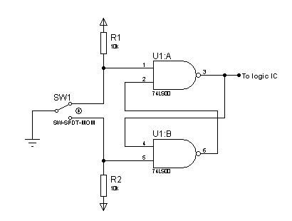

Now, the breadboard part, the down switch I used was a microswitch, connected to a debouncer, [https://3.bp.blogspot.com/_vh8XDhY5...AAABA/8tIEO7LV4A4/s1600/switch+debouncer.BMP]. I observed that the switch, even it is not pressed, it generates a small signal/a small voltage, which contradict/conflict with the condition I made in the counter section part. So meaning, it is always on, even its just 0. Which at proteus, we're only using LOGICSTATE so its only 0 or 1, so what happens, the condition which occurs only when the switch is pressed also works on the timer. After the 08 display, its supposed to dispaly 09, but instead displays 99. It means it down the tenths segment due to the debouncer, i replace the switch and debouncer with a coin slot and they are just the same.
I tried other debouncers, that doesn't have the same concept with the first, but the circuit does not work, counter doesn't work as well. Any suggestions? Ideas what to do?

Possibly some race condition occurs in the practical circuit of debounce. Try adding a small cap, say 1nF - 10nF range from each of your 10K to Gnd.

Hi i asked to know the operation of your project, so post your Proteus file or a schematic of it... To check a counter easily,
1, remove the debounce circuitry
2 ground the clock input with a 10 k pull down resistor
3,now give the pulses by connecting the wire on Vcc now check the operation and fix the problem on debounce circuit..
after that fixing debounce circuit is easy...

As a general good practise in digital circuits, ALL unused inputs should be either grounded or pulled up.
In the absence of such, there is a high possibility of incorrect functioning.
I notice that there are several places where such inputs have been left open/ floating.
Since you have already gone to great lengths to have proper debounce, then THIS might be the other cause of your troubles.

I deleted this since Venkadesh_M pointed out in #16 & #18 that the illegal condition can't happen the way the switch is wired up in this application. The only thing that can cause unexplained multiple output pulses is if noise is present on the inputs or power supply pins.
Hi the SW1 and SW2 or not two different switches in OPs requirement and also the race condition occurred in your circuit is when both witches open so A and B high that is not going to happen with a single switch because the cant make contacts between both positions.... for the circuit shown It will race in 00 input and not in 11 input.....
Deleted in relation to post#15
for 1 and 1 inputs its not going to race that means for the lever in between two contacts it will remain in 1 1 or no change condition..
your simulation results look opposite....
The race condition will only occur in 0 0 input that means closing both switches which is impossible........
I think he needs to get a digital scope and see what is actually happening to cause the multiple pulses. From a theoretical point, it should not change states but when there is noise, for some reason, you can get undefined behavior. So using a storage scope and capture the input states and outputs is the fastest way to solve this problem.
