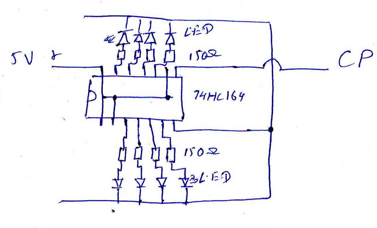

Hi guys
I'm using 74hc164 to drive some LEDs . and PIC24FJ96GA010 to give clock pulse
My problem is
its smoothly working when I give power to 74hc164 through my pic development LV24-33(3.3V)
but if try to give 5V from 7805 and clock pulse from LV24-33(3.3V) it is getting heat
Can anybody have idea about this?
Help me please
Thanks

Please change the 150ohm resistor to 330ohm or more... 150 ohm at 5 volts gives about 30mA...LEDs are drawing current larger than their operating continous current.

Use high ampere output 5V regulator i.e. 3A and always use heat sink with linear regulators
Added after 9 minutes:
And use resistor value accordingly
Although 20 mA or less can be actually expected, considering the LED voltage drop and driver saturation voltage, you should also pay attention to this specification:
absolute maximum ratings
Continuous current through VCC or GND ±50 mA
It requires a load resistor not smaller than e.g. 470 ohm when drivin 8 LEDs.
