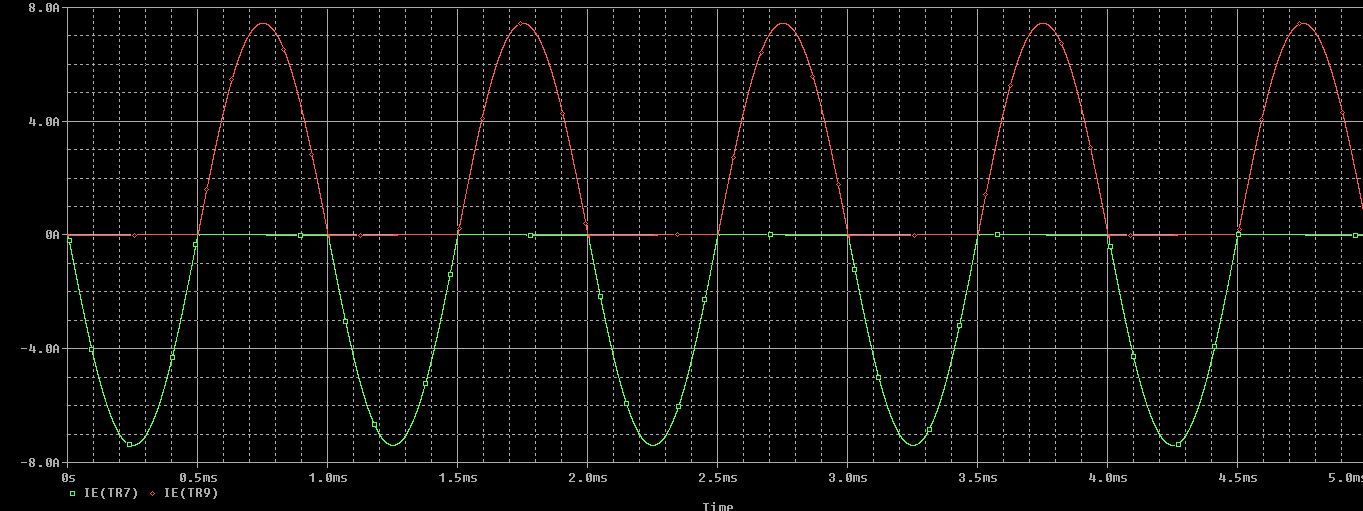

Thanks a lot for checking out my post, I really appreciate any help you can provide. I have been tasked with creating a blameless power supply, which is what I've done, according to the attached schematic. However the output doesn't match what the output should be by a long way.
I have a feeling I have made a mistake with the input of the schematic (How do I represent the NFB?) also PR1 is just a variable resistor that I've replaced with a regular resistor.
I have included my schematic, a copy of the output and a copy of what the output should be based on what I've been told, any pointers would be really appreciated, many thanks :)

Looks like there is another NFB node at the output of the original schematic. Try connecting the NFB at the input to the NFB at the output.
Also, I do not see any DC power in the simulation? The +/-37VDC?

Thanks for the reply!
I'll have a go with the NFB link as soon as I can. I assumed that the + and -37V power suggested an AC power supply at the input rather than 2 separate DC voltage supplies located elsewhere?
The text on the original schematic says, "Class-B Amplifier" which is wrong. It is class-AB.
I agree that the simulated amplifier will work much better when it has a power supply (+ 37V and - 37V) and has the negative feedback (NFB) connected.
The audio input says, "VAMPL = 37V" which must be another error.
Thanks for the reply :) So the AC input I have on at the moment at 37V and 1kHz frequency isn't working as a power supply? What should the input be then if the DC power supply is located somewhere else?
Your AC source on the input is just the input signal and not power. 37VAC will be too large but you will see this when you get things running. Add + and - 37VDC supplies reference to 0V/Ground where shown on the original schematic.

The two points marked "nfb" on the original schematic should simply be connected together.

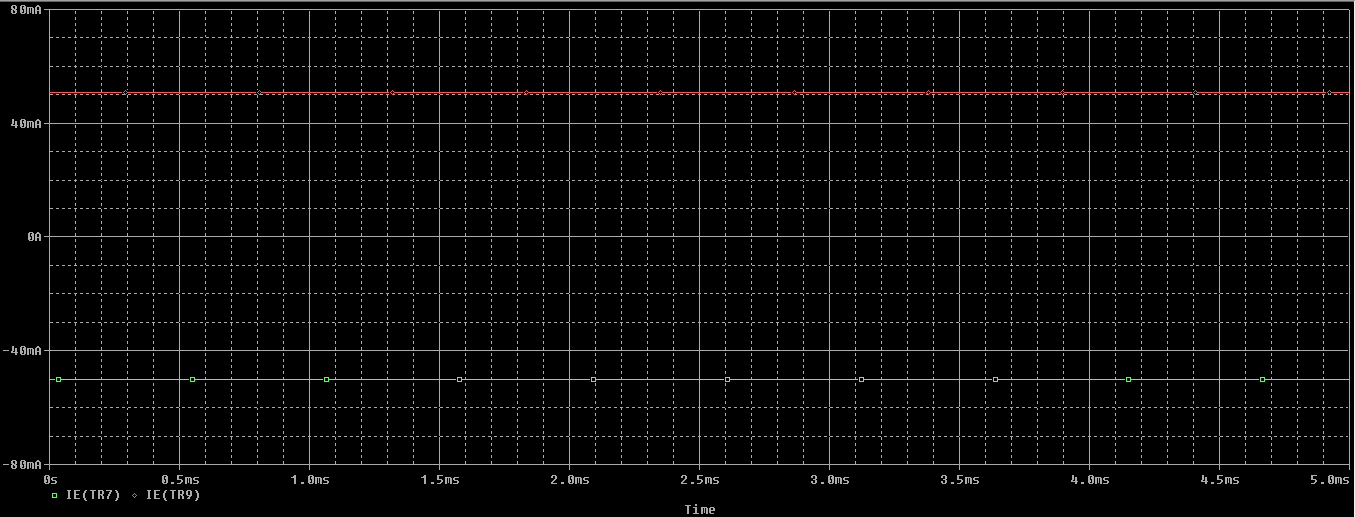

So, thanks to all your help, which I will reference at the end of this report, I have changed the circuit diagram appropriately. I have also changed the input voltage as specified in a part of the report to 1.414V, equivalent to RMS 1V. The output is much improved! All is well however the report specifies that the output current from TR7 and TR9 needs to be manipulated to create between 48 and 52mA. This is meant to be done by changing the value of the variable resistor, now PR1 however when I change this resistance value the output current doesn't change at all, any help would be greatly appreciated!
The idea is to set the DC current to about 50mA, when there's no input signal.
FWIW, I'm surprised he specified 50mA. The optimum setting for minimum distortion would be higher - probably about 100mA, as explained on his website, in his books etc.
So, I have set the input to 0 and altered the variable resistor PR1 to adjust the output current to allow the emitter voltage from the transistors to be approximately 50mA. However the current from both emitters is not strictly measured as +50mA, one is positive and the other is negative. I'm assuming this is okay however and due to the negative and positive voltage supplies, since they are both relative to these power supplies the current is effectively positive on both?

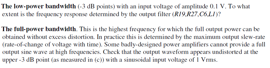

I've been working through some of the questions for this amplifier and so far it's been going well, however, now I've been tasked with measuring the high and low power bandwidths. I know what bandwidth is but I am having troubles where and what exactly I should measure, if you guys could point me in the right direction that would be great. The full questions are attached
Now you have a nice amplifier BUT your load is only 4 ohms which might overload and overheat the output transistors. The article I posted about this amplifier has an 8 ohm load for an output of 50W.
Thanks a lot for the reply :) The question paper actually specifies a 4 ohm output for the circuit and that it is looking to drive 110W into a 4 ohm load
The parts listed have their functions described in the design article of this amplifier I posted.
R27 and C6 are not a filter. They are a zobel network. It provides a low impedance load at high frequencies where a loudspeaker becomes a high impedance due to its inductance. When the load on the amplifier is high at high frequencies then inductance or capacitance at its output might cause oscillation.
R19 and L1 prevent a capacitive load from causing the amplifier to oscillate. A speaker with a crossover network becomes capacitive near its crossover frequency. The cable connecting the amplifier to a speaker has capacitance. R19 reduces the Q of L1 to prevent ringing.
I think all these parts do not affect the low power frequency response of the amplifier.
It is easy to measure the low frequency and high frequency -3dB points. EDIT: An audio amplifier is not measured up to 10GHz. I think this one is -3db at 80kHz that you cannot see on your very wide range of frequencies.
Maybe you should mention in your answer that this "blameless" amplifier was designed for 50W into 8 ohms and might be overloaded and might overheat with 110W into 4 ohms.
