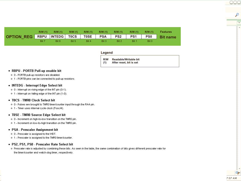

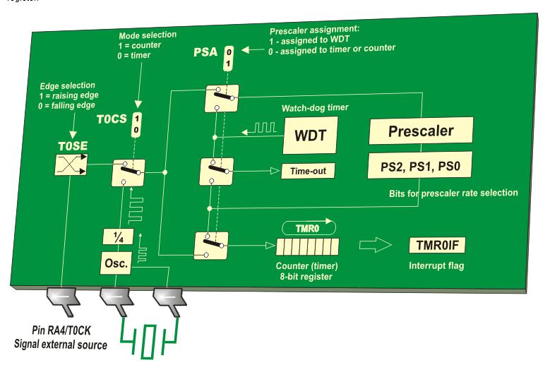

Hi guys I have confusion in assigning PSA to WDT or Timer
In the pictures you can see there is a difference.
In one picture
PSA = 1 to assign to WDT
while in second picture
PSA = 0 to assign to WDT
What I have learned
PSA = 1 means Timer/Counter
Can someone answer what is right?
Hi Tahir,
this is correct bcoz this basic assignment is followed in pic microcontrollers
PSA Prescaler Assignment Bit=1 means assigned to WDT
PSA Prescaler Assignment Bit=0 means assigned to Timer0 module
hope this may clear your confusion best of luck
