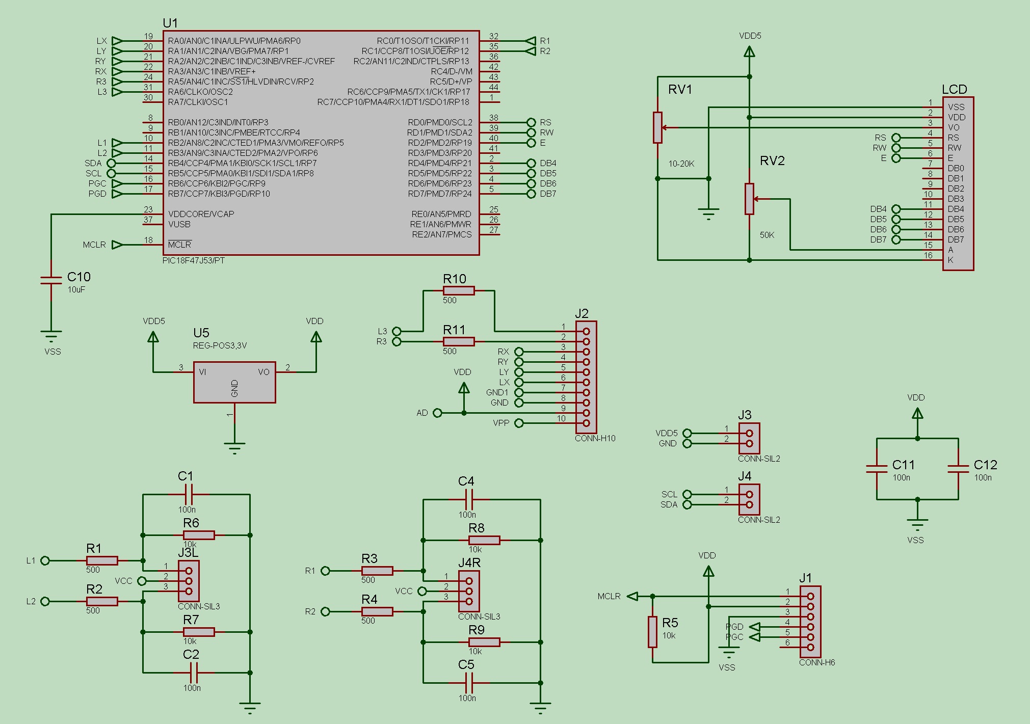

So, I have searched the forum, and asked my teacher, and everything seems to be correct,but it doesn¨t work!
I have a 3,3v PIC Communicating with a 5v LCD in 4-bit mode, I'm using 5v tolerant pins and the lcd logic has minimum of 2.2V.
I have measured all the pins and they all rise and fall as they should, but all I get from the LCD is all the pixels in the top row lit. I'm at a loss of what to do at this point, and hope someone spots whatever I have done wrong.

which controller you are using?
is it one time programmable? i think it is one time programmable bcoz it is 18cxx and c is shows that.
so if you burn for many times then previous programs remain in as it is. so it will not worked properly.
What do you mean one time programmable? I'm using PIC18F47J53 and I have other projects that work on this mcu ( even I2C communication ) and I've changed programs on them multiple times.

Re: PIC -&gt; LCD Communication problem
That DOES seem to be a better way to do it... I'll try it tomorrow, as school is over for today. I'm not so sure if there's a difference though, but I'll try anything :)
Seems to be a common error, improper initialization / improper timing.
The code provided by embpic does seem to work, as far as compiling and programming goes. The LCD just sits there with all the pixels on the top row lit though, I'd at LEAST would expect it to be empty..I Got problems with the E pin connection and changed the connector I use to a more reliable one. Now a single square on top was blinking slightly, but all the pixels on the top row were still lit... When I turned it off, I saw the shadow of the cursor as the screen turned off, but as I turned it all on again, it didn¨t work anymore....
Ground RW pin as u don't need RW pin for writing operation. Also try with D0-D4 instead of D4-D7 initially then change hardware pin after ur LCD work,
Grounding the RW did squat..
About the code from embpic: does it seem ok? The initialization seems a bit strange, considering it tries to send the byte in 2 parts before the lcd is set in 4-bit mode...
SOLVED: Here's the code that finally worked. The example I used had it initiated with 8 bit communication, even though it was a 4-bit example. The Lit pixels on all the squares was solved with lowering the contrast (forsome reason)
