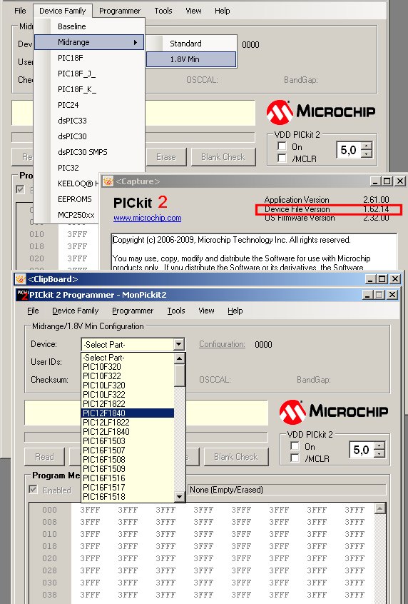

hello pic geeks, it seems pickit2 clone doesnt support this 8pin pic micro controller. can any one suggest me a simple usb programmer for the same. i like to design it myself

hello,
in Pickit2 Microchip original
PIC12F1840 is inside family 1,8V !
event this MCU has a minimum of 2,5V as power supply.
If your clone uses the same software as the genuine Pickit, go to Microchip's web site and download the latest "PK2DeviceFile.dat" file. Mine certainly has full support for the 12F1840.

Not sure if the OP is really trying to program via MPLab rather than the PK2 Stand Alone program V2.61.
Have to say even with device files 1.16.14 or 1.16.15 loaded in there is no sign of the pic12f1840 on the drop down menus.

hello,
we can find it with device files 1.62.14
PIC12F1840 is hidden in
Device Family
      Midange family
             1,8V min
12F1840
we can find it out here
Thank's for the link of updated PK2DeviceFile.dat
wich propose new MCU
