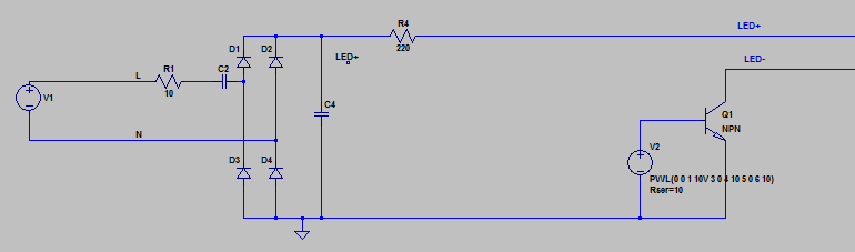

I have a QDC driver which is driver by NPN transistor, and it will drive LEDs,
when i turn ON the MOSFET i have a peak current, and the LEDs does not support this hight current ( 140mA peak),
the problem is that when the transistor is turned ON, capacitor C4 will give a current with the mains,
can you help me to solve this issue ?
Your circuit has no switch. It has no AC power supply voltage V1, has no capacitor values and has no LED forward voltage.
Your scope shows the current through D11 but your schematic has no D11.
Then we do not know what you are talking about.
yes i moved the values in order to make the schematic clear,
V1 is AC source 230VAC/50hz,
Q1 is the NPN transistor used as a switch,
due to the big quantity of LEDs=60 it was difficult to put them all in the picture ,
i have LEDs from D1 to D63,
the capacitor value C4 is 6.8uf
is it clear now ?

C4 will charge to the peak voltage which is about +309V but since you did not say the forward voltage of your LEDs then I cannot calculate the current. I see no current surge if the value of C4 makes it a good filter.

the total forward voltage of the LEDs is 192V, yes all LEDs are in series, and i need a current around 16mA throught the LEDs,

You have a very high current in R4 and the LEDs because the voltage across R4 is very high. The voltage and current will be less when the value of C2 is reduced.

I presume that switching C4 footpoint to Q1 collector will fix the LED peak current problem, unfortunately creating a transistor peak current problem instead. You might find a compromise in splitting the total series resistance between R1 and R4 differently.
In any case, I doen't see a particularly reason to have C4 in this place.
C2 is also part of the series impedance. If you remove the C4 and adjust the value of C2 to a value that is correct for the voltage you want out of the driver circuit. The peak voltage value at start should go down a bit.
Another possibility is to keep the C4 and add a zener diode over it to bleed away the voltage buildup. This will give you a slightly higher start voltage, but nothing like the one you have now. You should still adjust the C2 to the correct value. The wattage and cooling of the Zener is depending on the value of C2, and the time the LEDs are off.

i have a reason to put C4 there, because if i put it in parallel with LEDs, and if the transistor if switched OFF, and i have ground layer in the bottom layer, i will create capacitive coupling between TOM layer and buttom layer, because the capacitor is not filetering,
so a small eakage current will flow throught the LEDs

yes i already have only LEDs in series, and the current throught LEDs needed is 20mA, i do not accept 140mA current ripple, and the maximumm ripple current is 40mA, i don't understand why you are talking about battery, but i guess 320 V battery will be so big,
C2 is the current limiter, but the problem come i switch off the transistor, and when i switch ON, a huge current come from C4( because C4 stay charged), and this current will be limited by R4

the only solution i have now is to increase the value of R4, to for example 2k, and also increase the value of C2, in order to keep the current through LEDs the same,
but in this case the system efficiency will decrease because i will dissipate throught R4,
playing around R4 and C2 will solve the problem, but decrease the system efficiency, i am looking for other solution,

Take a look at the last paragraph in my post #13. The reason for the over current when switching on the LEDs, is the no load charge of C4 to peak voltage 300+V. If you load it with a Zener diode(s) that is slightly higher in voltage than the normal loaded LED voltage, you will not have the big current peak when switching the LEDs on. You should select the zener voltage to be some volts more than the normal loaded LED voltage.
The zeners will burn around 4W with the LEDs off, so you should combine a number of zeners in a string that will split the load into small enough chunks of the total power. You must also adjust the value of C2 so the current will be 20mA in both the LEDs and the zeners.
