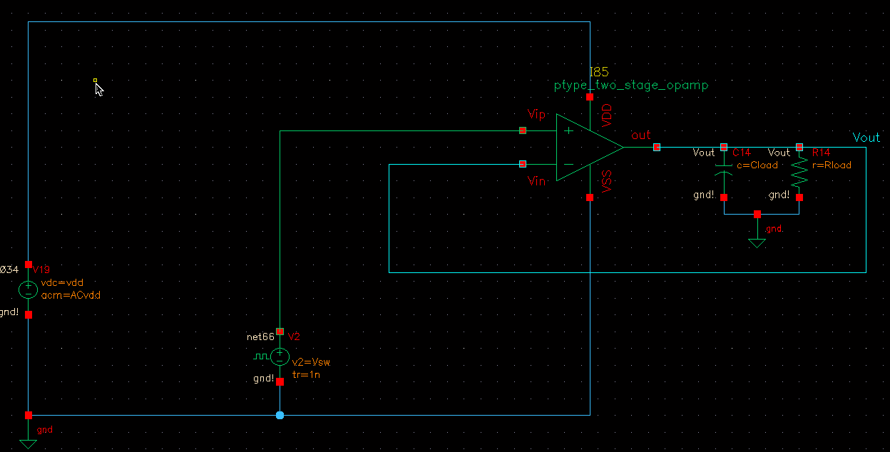

For SR simulation, i have following circuit configuration with output loading Cload=10p & Rload=1Mohm

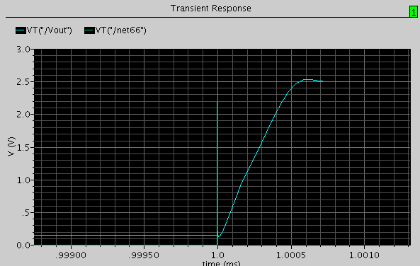

I run virtuoso every is fine as following:

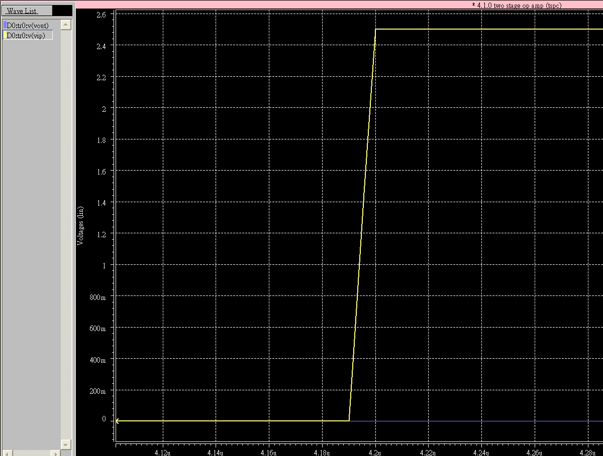

When running hspice, the Vout is something wrong as following:
the Vout seem to never work(Vout:0v->2.5v)?
another interesting, Vout work fine in hspice when exclude Rload.
Do i miss something or this is hspice bug???
