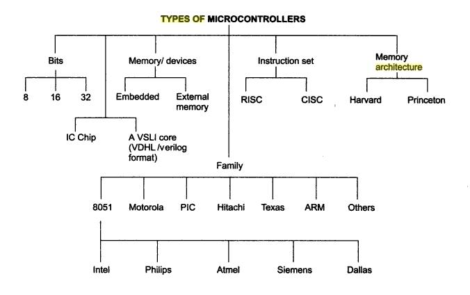

Not exactly companies, MCUs differs by their architectures. Compilers are found separate for PICs, 8051s, ARM, etc. Also in these categories, there are many sub categories of MCUs and they all come with different compilers & programmers. You have to choose any specific MCU which suits your job, and go with it. If you are new, start with 8051 & PIC.

Hi Genovator
Thanks for the reply. Is there a table where I can find main features of these different categories of MCUs and their possible applications?
