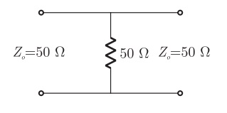

I don't get how Pozar used the voltage division rule twice to solve for S21. Can anyone explain in detail? Please!

We know that S11=(Zin-Zo)/(Zin+Zo) where Zo=50 ohm and Zin=50/2=25 ohm (you have the load in parallel with the 50 ohm shunt) so:
S11=(25-50)/(25+50)=-0.33
due to the symmetry S22=s11
about S21 take into account that V2=V1*25/(50+25)=0.33. The same to calculate S12
Also, S21 = (2*Z21*Zo) / (((Z11 + Z0)(Z11 + Z0)) - Z12*Z21) = 2/3 ! But how to do it directly without conversion? I don't get it!
But in the answer S21 is given as 2/3 and not 1/3!
Not sure if I'm looking a the correct figure, but in the one I'm looking at, V1 (the left hand side) = V2 (the right hand side).
The input power is divided equally between the resistor and the output TL. Since (1/9) of the power reflects, the remaining power (8/9) is divided between the two loads, such that each receives (4/9) of the power. The insertion loss is related to the power which is received by the output TL, which is the square root of (4/9) - 2/3.
What I said is that to calculate S21 you have to take into account the relationship: V2=V1*25/(50+25)=0.33, not that S21=V2/V1
In fact S21=2*(V2/V1) that is 2*0.33=0.66
We must not be looking at the same image.
If you prefer working in terms of voltages, V1 = V2.
V1 is the sum of an incident wave a1 and a reflected wave b1. => V1 = a1 + b1.
We know through the reflection coefficient that => b1 = -(1/3)*a1.
Therefore, V1 = (2/3)*a1.
Since at the output port, only the b-wave exists (there is no excitation and the impedance is matched), a2 = 0, b2 ≠ 0, and => V2 = a2 + b2 = b2.
Since V1 = V2, V2 = (2/3)*a1, and therefore, b2 = (2/3)*a1.
Since S21 = b2/a1, we have in conclusion that S21 = (2/3).
