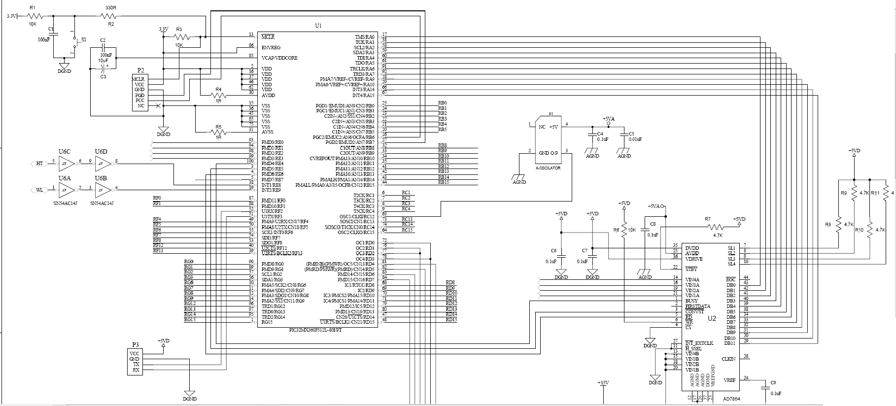

Dear friend,
I am a bit familiar with the PIC18 series controller. I am trying to use PIC32MX360F512L controller. When I am trying to programme the controller with the PRESTO programmer, device id 00000000000000 error is displayed. I have powered the controller according to the specification.
I need suggestion from you.

usually device ID 0 indicates the programmer is not connecting to the device correctly
do you have the PIC32 circuit?
what version of MPLAB and compiler are you using?
it may be worth getting onto PRESTO support?

Yes I have the PIC32 circuit which I designed and I will upload the schematic within a week as I am in outside my city.
I am using MPLAB IDE v8.30 with C32 compiler from Microchip.

may be worth upgrading to the latest MPLAB (I think it is V8.89) or even MPLABX (you may not have a driver for it though)

I always find that it is worth looking a Microchip's user guides for their kits as the guides usually have schematics of the circuit, e.g. PIC32 Start Kit user guide
here is the programming circuit for a PIC32MX575F512 for one of our PCBs
Thank you for your suggestion .. i am sharing the schematic of the my PIC32MX360F512L circuit. Please have a look on it and suggest me if i have done any thing wrong ....

The schematic looks O.K. Are you reasing recent UP software version for the PRESTO programmer?
as FvM says schematic looks OK
have you an oscilloscope to look at MCLR, SDA and SCA to check the signals look correct
Thank you FVM and horace1. I am using UP 2.54 version of software. And I will check the status of MCLR, SDA and SCA pins.
According to UP release notes, the chip should be supported since V2.38. So there's probably a different problem. Updating to the newest programming software won't hurt, however.
