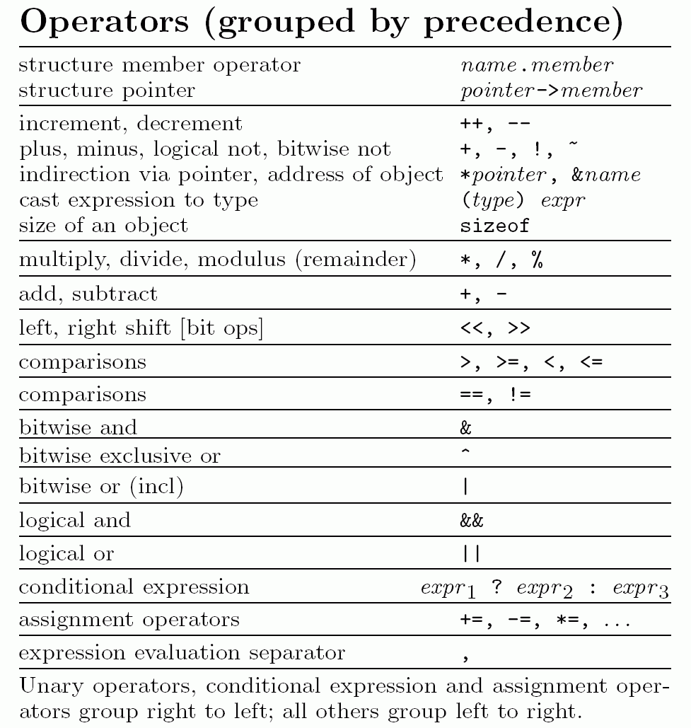

is this a wright way to write
if(count_dd==0 && count_ee==2 && mt==1)
in C code or I have to write
if((count_dd==0) && (count_ee==2) && (mt==1))
Review your favourite C text book for operator precedence to answer the question
Priority in first expression have the same result as the second one.
Have you tried it and had any problem?
I don't think so.
Both the statements are correct, but second one is clear and neat.
As per the operator precedence the conditional operator checks first
i.e ==
then logical AND &&
