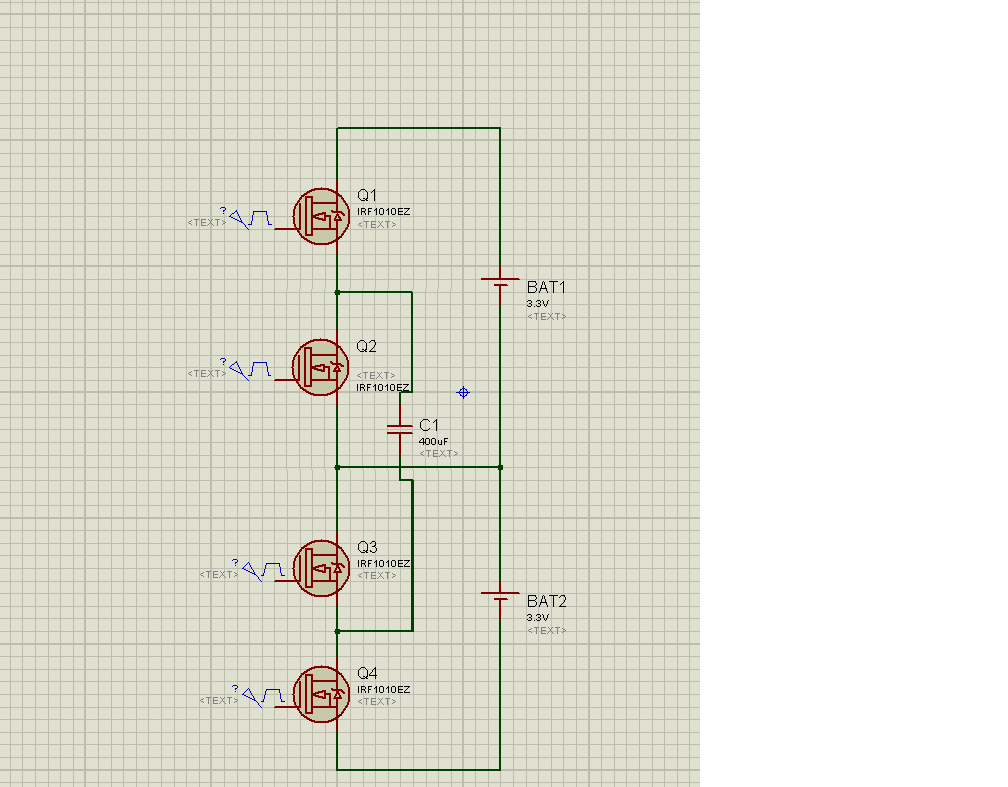

what do you mean by low side switch ? and bootstraping?? simply i will connect each gate of the MOSFET to an output of the MCU that generate two PWM signal with dead time,

look at this shematic, i will switch the capacitor between the two two cells in order to charge and discharge it to equalize the two cell, i will drive the two MOSFET with the mcu, what do you think should i insert a bootstrap and how ?
Think of it like this:
In high side configuration, the load is between the source of the MOSFET and ground, the drain is connected to the positive rail. This means that the MOSFET sources current - the MOSFET provides the positive voltage.
In low side configuration, the load is between the positive rail and the drain of the MOSFET, the source is connected to the negative rail. This means that the MOSFET sinks current - pulls the negative end of the load to ground.
In high side configuration, the MOSFET has a floating source - its source is not connected to ground and to switch the MOSFET on, you need an additional 10v (above the level of the positive rail) by charge pump or boost or bootstrap or other methods, or you could have an isolated power supply and switch the MOSFET with respect to the isolated power supply.
If you are driving something like a lamp, motor or relay and it is possible to use the MOSFET as a low side switch, do so as this simplifies the circuit design. What will you do with the PWM signal? That will answer whether you require a high side or low side configuration.

Q1 and Q3 are in high side configuration (I explained this just now), so require high side gate drive (bootstrap would be easy). You could build a discrete driver, but you will get better results (better rise/fall times) by using a driver IC such as IR2110.
---------- Post added at 00:04 ---------- Previous post was at 00:01 ----------
I'm not exactly sure what you're trying to do. Is it possible to use a different configuration, one employing low side drive?
Is that 3.3v power supply the real value you will use in your circuit?
If it is then with a simple 6v-12v supply you will be able to drive the high side mosfets with a proper Vgs.
Alex

as i axplained above this capacitor will equalize the two cells so that they will have the same voltage,
so i need to switch this capacitor between the two cell in order to charge it and discharge it

Yes Alex i will is the power from the cell in order to supply the circuit
---------- Post added at 19:17 ---------- Previous post was at 19:12 ----------
the true MOSFET that i will be use in my project is https://www.fairchildsemi.com/ds/FD/FDC6401N.pdf
will you have any higher voltage available (>6v) or the only power supply are the cells?
If you are going to use the bootstrap solution then maybe you should use a proper mosfer driver but your supplies are very low and you may have problems there...
This is an example of a discrete mosfer driver with bootstrap (it was for a 12v supply), note that your voltages are very low, from the 3.3v you will loose about 0.7v on the totem pole and about 0.5 on the bootstrap diode, you will barely get 2.5v Vgs
Alex
Alex
i will use oonly the power supply from the cell, but i have not 12 V in my design, yes but i can use this in my shematic, no?? and replace the 12 V with the 3.3V
the Vgsth of the mosfet is 1.5V and i think this can work, what do you think ?

And the problem is? If you look at Figure 5 in the datasheet, 2v at gate will allow you the MOSFET to be used for maximum current. According to Figure 4, RDSon is also acceptable at 2v. Remember, this MOSFET has a gate threshold voltage of only 0.9

the problem is can i use the same component as mentionned in the picture that alex give to us ? and only change the voltage 3.3V with the 12 V ?
Yes you can. In the 2nd circuit, the addition of the transistor means that you drop another 0.6v. You could use a TLP250 with a diode and capacitor to provide bootstrap as well.
