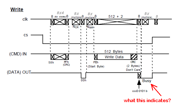

Re: MMC multiple block write problem. (What is "BUSY" in the diagram i provided?)
