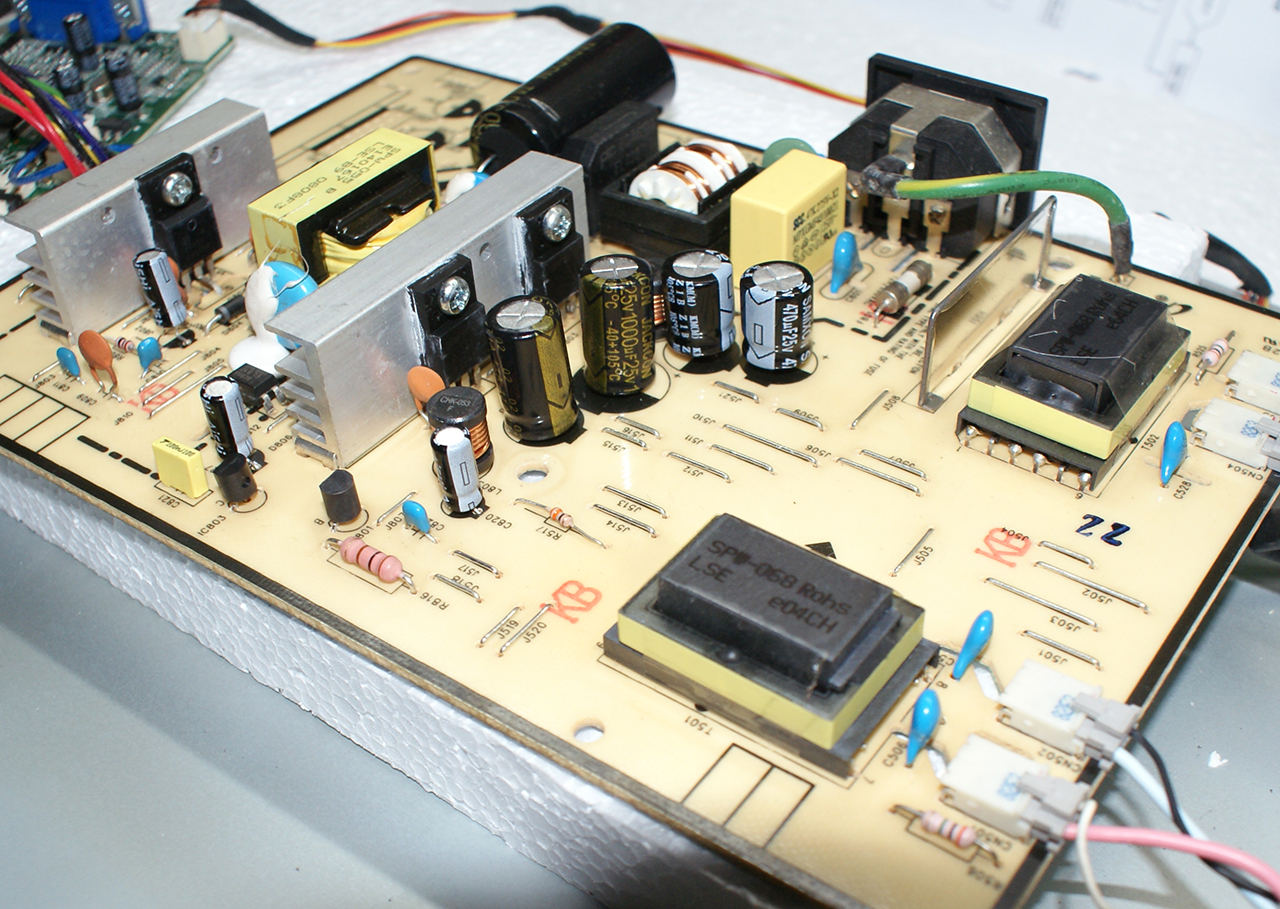

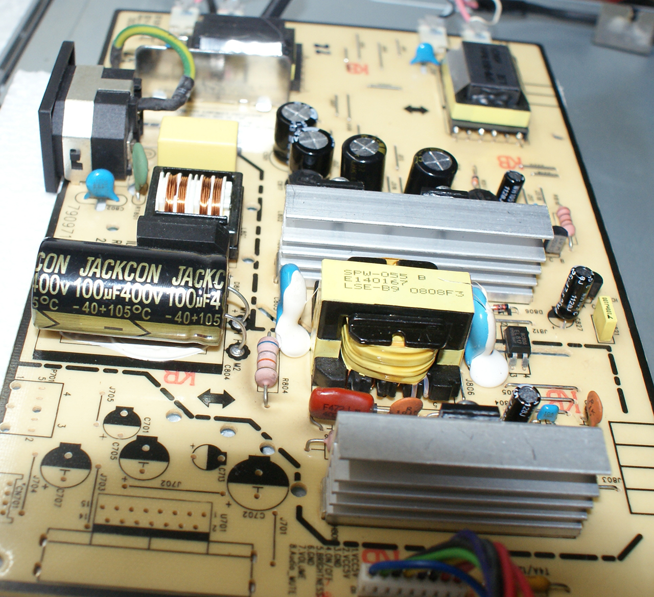

i don't have any of those numbers in the board... all are 500+ and i can't find any ZD anywhere... i'll post a pic of the back of the board here in a bit...
here is the photo of the back of the board:
thanks for the heads up betwixt, i'll check it first thing in the morning and put values here.
