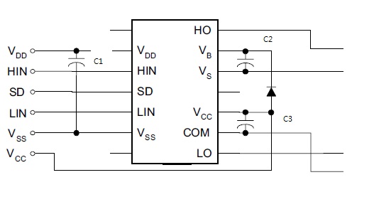

Hi guys, we are trying to use ir2113 to drive the IGBT for our project. We plan to make an H-bridge using the IGBTs but we cant drive the IGBT using our IC. When we tried placing our PWM as input in the HIN pin of the IC, the HO pin only outputs a straight DC voltage.
When we tried on the LOW side, it worked fine.
Our PWM is 0 to 5V
VCC = 15V
we followed the schematic in the datasheet of ir2113
can anyone suggest a specific configuration that we need to do to activate the HIGH SIDE.

In order to activate the high side, the bootstrap capacitor has to be charged from a path to the ground, how exactly did you make the test?
Can you post a schematic?
Alex
This image is the schematic what we used
we used 0.1uF and 10uF capacitors
VCC and VDD = 15V
COM,VSS,SD = Grounded
HIN = 0 to 5V input
LIN = 0 to 5V input
we are just checking the output at HO pin and what we get is a DC voltage, which is about near VCC.

Vs must have a path to ground so that bootstraping can work properly, do you leave the output floating?
Alex
OK, to make it work needs the presence of a low side fet (Vs must be connected to the drain of the low side mosfet/igbt), when this fet is turned on it allows current to flow into the bootstrap cap which then allows the high side output to work, so no low side device = no high side operation. The only other way to get the high sdie going is to put a fully isolated supply (e.g. a 12V battery) across the high side bootstrap cap - this will power the high side output - hope this is all clear - regards, Orson Cart.
The datasheet schematic shows that Vs should be connected to the source of the high side mosfet so using just a high side mosfet with a resistor load would be enough to make it work.
Alex
When you say "leave the output floating" do you mean that the output is not placed in the gate of the IGBT / any device? if so then YES, we left the output floating and tried to see the output w/ an oscilloscope.

Yes by floating I meant without any connection and no it will not work this way, you have to connect at least a mosfet/igbt in the high side with a resistor going to the ground as load.
The bootstrap capacitor would probably be able to charge through that resistor, if not then you need the low side device too.
Alex

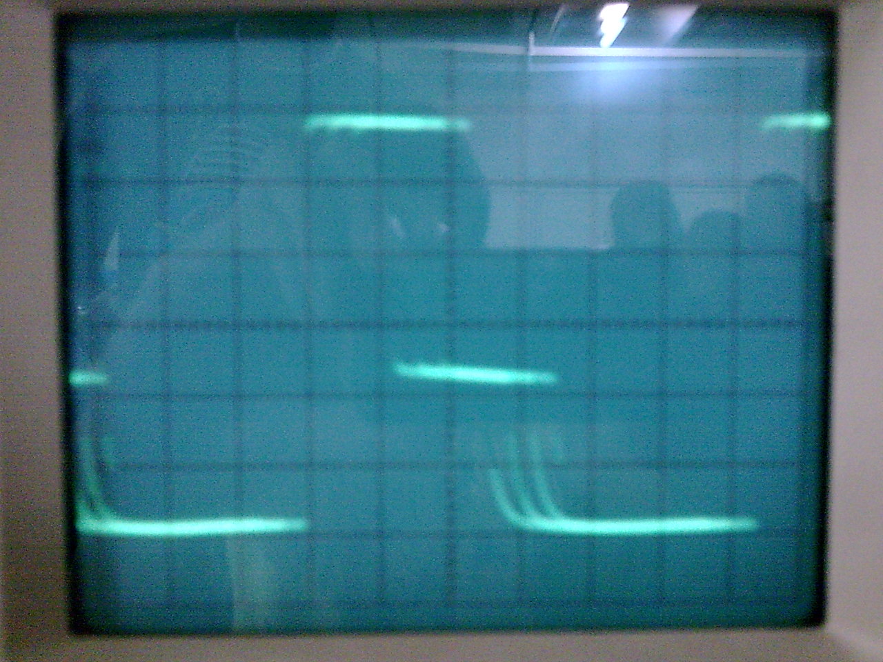

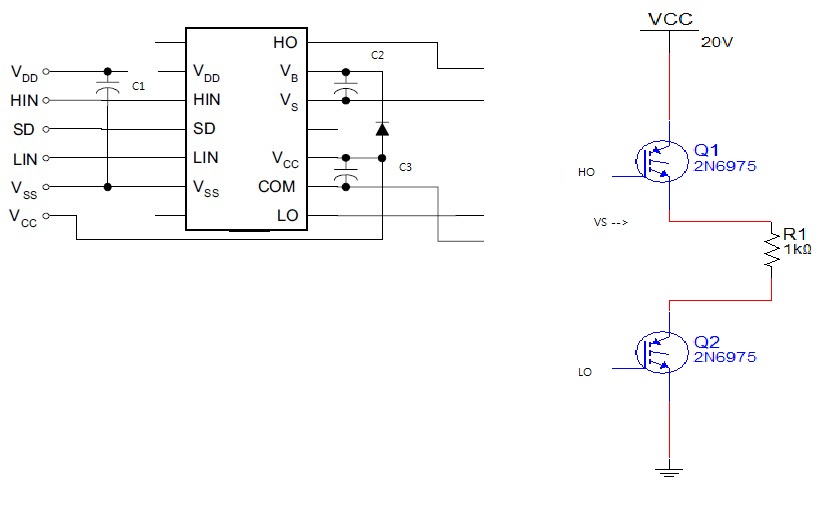

Hi Guys. i tried to connect the VS to the source of my high side IGBT. This is my schematic. Sorry if the drawing is not that good, i dont have an IR2113 on multisim. For clarifications, just ask me.
The HO was 0 to 30V our VCC was 15V, we also had a 20V supply on the drain of the IGBT. The waveform of HO was almost a squarewave but there is a distortion... what could possible be done for that?
