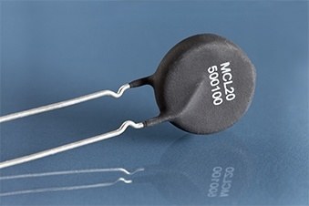

I would look at an NTC or a PTC:

Thanks, we're thinking of moving over to NTC's instead of resistors......or, in combination with resistors.....te NTC will just immediately get hot and reduce its resistance rather than blow......i've seen offline 200-265VAC power supplies with a small 1cm NTC of 80R doing inrush into 480uF (output of Boost PFC)...so in other words......we woudl need 10 of them in parallel.........but then we only have 8R of inrush limit......so maybe we will seek those white 'bathtub' resistors...thats what was doing inrush on the 10kW three phase electric drives i worked on.

This app note shows a 3r3 NTC being used to inrush into 1.1mF....wont get much limitation from 3R3...and thats the cold resistance....

From research on the web, it appears that for mains inrush into >2mF, you are supposed to either use NTC's, or a precharging regulator.......inrush resistors are not supposed to be used, however, we cant use NTC's , so will do the two 47R's , and then work on the pre-charge reg in a feww days time.

I think a suitably derated ICL with a low PTC operating temperature point or with bypass relay and restart delay of the thermal time constant would be suggested. In PC's PSU's they use about a 2 second inhibit restart time for 0.5kW with PTC's.
