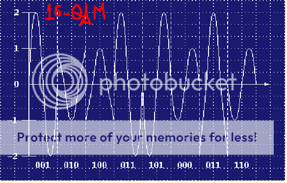

At the output of my DSP i have a 16-QAM analog signal fc=10KHz and BW=20KHz like this one: https://i1284.photobucket.com/albums/a578/fovos1/16QAM_zpse9ee0bf9.png
I have one output port at DSP.
So i can use a 90 degree splitter to create the same 16QAM like above but with 90 degree shift? So i will have I and Q signals
And then use a I/Q modulator to upconvert this one with carrier 100MHz?

Ideally you need to be generating two signals from your DSP. One for I and one for Q.. you need, in some way, to create another port.
A passive phase splitter on the above signal would only give a fixed 90 degrees offset.. all your modulation would end up either high or low of your LO.
You could just centre your modulation at a fixed offset (that might be what you've done, I can't immediatly tell from your plot) then use a phase shifter to generate the 'Q' from the 'I' thus giving you an up converted signal permnently to one side of the carrier and an image say 30dB down on the other side of the carrier, you can't do this and get your output to work above and below your carrier.
