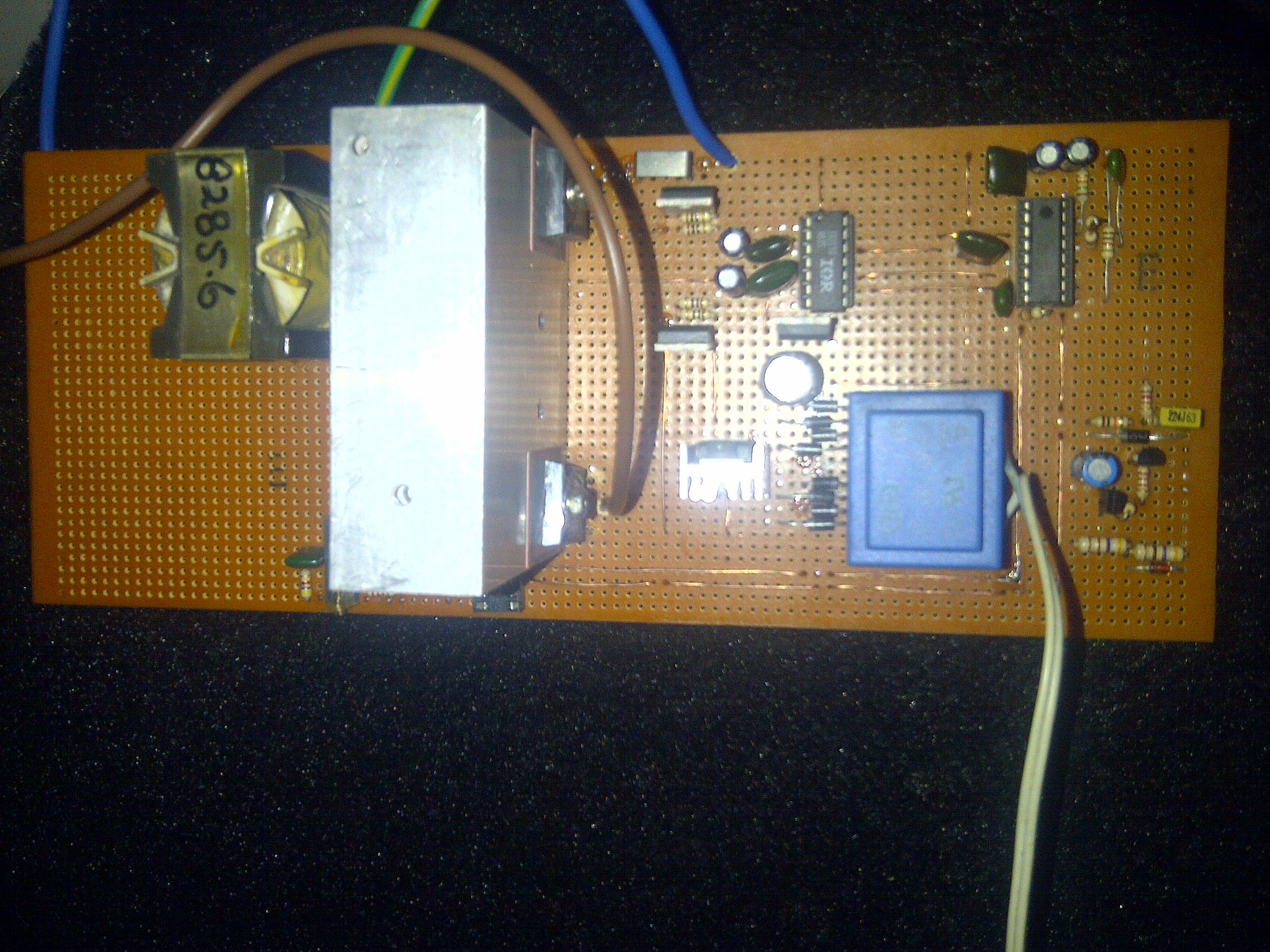

After designing this charger, it worked but the ferrite transformer was getting so hot.
My ferrite transformer winding is 27 turns primary and 6 turns secondary

which transformer are you talking about ? And which core & size are you using ? And why are your turns ratios different ?

Thanks for your quick reply. I live in Nigeria and it is so hard for us here to get core sizes we want so I made do with one from a smps unit I bought here. I recoiled it to that spec so as to accommodate more stress. And I am using it to supply 12v dc. Pls advice. Thanks
Mr ade is it only the core that is heating up or with your mosfet?
This design suffers from the danger that if the two half of the secondary are not perfectly balance the difference in voltage will result in a a current flowing back through the smoothing capacitors (the 4 X 47000). this will result in dissipation in the transformer/diodes/capacitors.

Ok but I did not recoil the secondary transformer as in the circuit
I think you problem there could be from your transformer.
I finally pulled a transformer from an atx power pack and am in the process of getting it fully installed
The circuit is a popular design check the frequency for 60Khz if it is ok then Check Transformer
Pictures of the new design. Please comment. I have tested the circuit without the chopper transformer, everything works well. I am going to test it with the chopper tomorrow.
