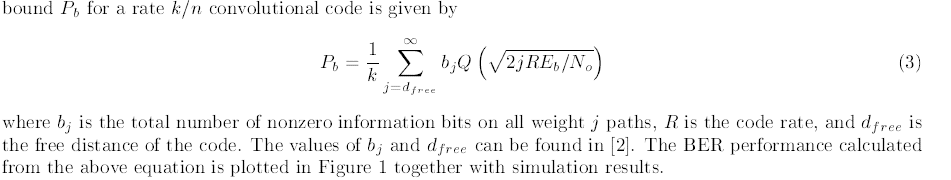

I wonder if you know the answer of another issue I am facing w.r.t to theoretical Probabilty of Bit error equation in Text books.
I don't have Reference [2] which is
[2] L.H. Charles Lee, Convolutional Coding : Fundamentals and Applications. Boston, Mass.: Arctech House,
1997.
I know from Proakis dfree = 6 for K=4, now looking at the description bj is the total number of non-zero information bits in all weigth j- paths .... How to calculate this , looks like I need to simualte this and this could be different based on the receive sequence and the summation is from j=dfree to infinity , but surely I have to stop at finite length.
Do you have any idea about this ?

Hi in8214,
I went through few books, but couldn't find the solution to your problem. :( Will let you know when i find a solution to this.
