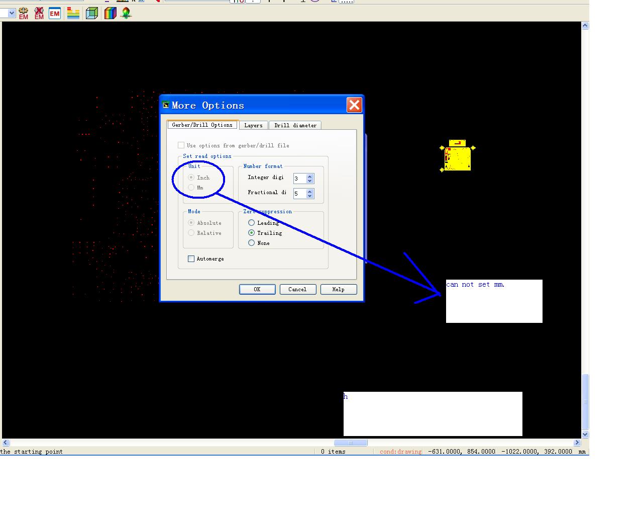

Hi all,
I want to export photo plotter and nc drill with mm or mil unit in PADS2005,for the default setting is inch.I attached the photo,Any friend can tell me how to set the parameters? i have tried many times to generate gerber and NC drill files,but when i imported them to another EDA software,i found NC drill's location is not correct.Thanks.

Although i'm not using PADS, the problem lies within the output format.
When generating gerber or drill files you have to set the output format to something like 3,3 or 3,5, english or metric.
When reading in the generated files in a gerber viewer you have to be sure that the settings of this viewer complie with the settings of the generated files. So check the input settings of your viewer when importing the gerber files and the drill files.

Thanks for FvM's reply.My problem is when i select the default setting(inch) and import to ADS(support 1e-6 resolution--min).I will indicate the low resolution,and affect the result.When i generate gerber and drill by mm unit in pads,usually get incorrect result in ADS.I do not know how to set by mm unit i pads so that i can get correct result.The above attached is the settting form.Anyone kindly guide me how to set?
The shown setup dialog only affects photo plot (gerber) not drill data. It can be set to inch (english) or mm (metric) and trailing digits (resolution) of your choice. A similar setting should exist for drill data.
Sure!It is photo plot.The drill is similar.when i set plotting size:X: Y:.If i set it mm,ADS can not import(but mm is disable)
