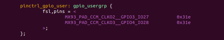

Create a new set of pin alternates under iomuxc node, and the two GPIOs are LED light D6 and button K1 on the carrier board.
Device Tree Pin Alternate Function

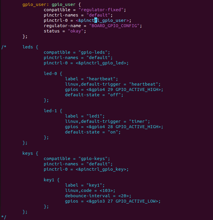

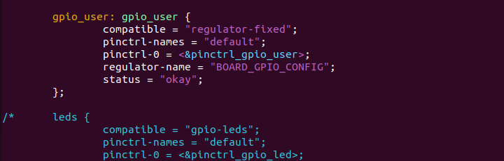

Annotate LED and KEY parts to avoid alternate conflict:
OK-MX9352-C DTS
Compile DTS after Save & Exit

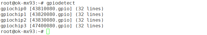

3.1 gpiodetect
Check all GPIO devices.
Above gpiochip0- gpiochip4 match with GPIO1- GPIO4 in the DTS respectively. However, it’s not in the order one-to-one, which is caused by the issue of the corresponding register address order. So how does goiochip0 match with the DTS? We can open the dtsi file in the device tree,
path:OKMX93-linux-kernel/arch/arm64/boot/dts/freescale/imx93.dtsi
forlinx@ubuntu:~/ok-mx93/OKMX93-linux-sdk$ vi OKMX93-linux-kernel/arch/arm64/boot/dts/freescale/imx93.dtsi
We can see register address of GPIO3: gpio@43820080, which corresponds to gpiochip1 , and GPIO4 corresponds to gpiochip2.
address of GPIO3 and GPIO4
Followings are other GPIO’s corresponding relationship, please refer.
other GPIO corresponding relationship
