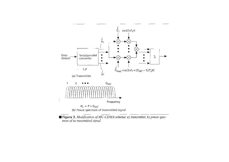

Added after 56 minutes:
what is happening after multiplication with different carriers in each parallel branch.should ther be P IFFT blocks??is that a product sign after the multiplication with carriers??

kindly copy the link of the above figure in a new window and then open it..
