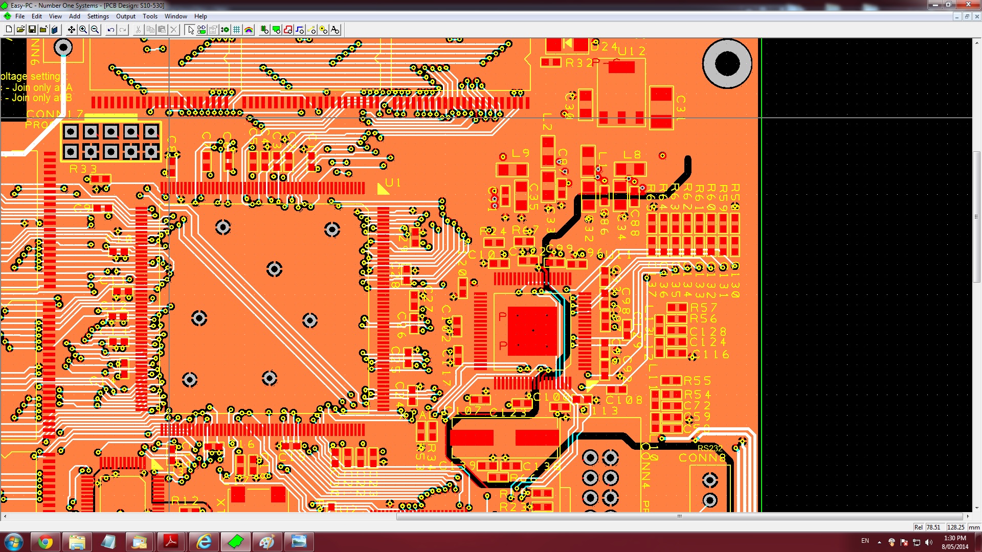

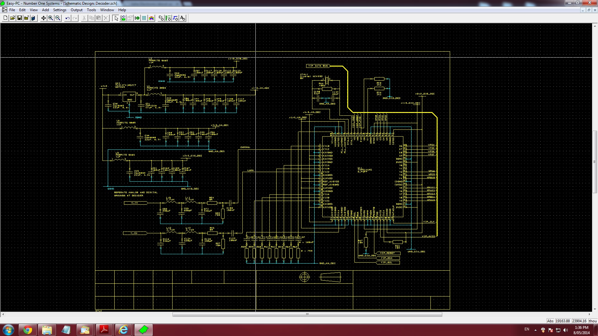

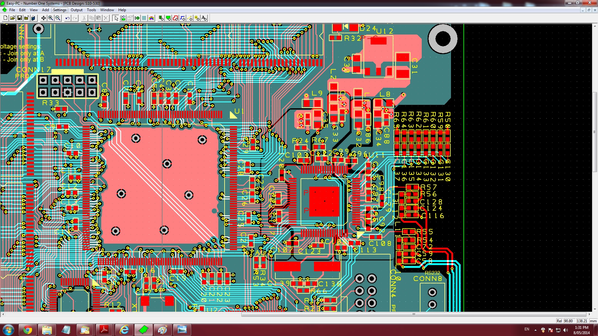

I have attached images board layout and schematic for the decoder part of the PCB.
The green layer is the power plane. The large 208PQFP is the FPGA. The chip to the right is the TVP5146. The ground around the decoder is split into +3.3digital, +1.8digital, +1.8analog and +3.3analog as viewed from left to right. The sot223 device above the TVP5146 is a 1.8v regulator.
The brown layer is the ground plane. I have split it under the TVP5146 and all analog circuitry is to the right of the split. The analog side of the ground plane extends down the right side of the board to the Y/C inputs connector. There is nothing else connected to this part of the ground plane.

If you split digital and analog ground, the single point of connection between them should be at the TVP5146. Look at the application example in the data sheet, section 5.1. The schematic suggests how the ground can be separated. Pins 26 (AGND) and 27 (DGND) should be directly tied together, that is the single point of connection. Ground planes are not discussed in the data sheet, but I suggest that you don't split the ground planes below the TVP5146.
Extend the "single point of connection" to the whole area occupied by the TVP5146.
It is easy to do more harm than good with ground splits.

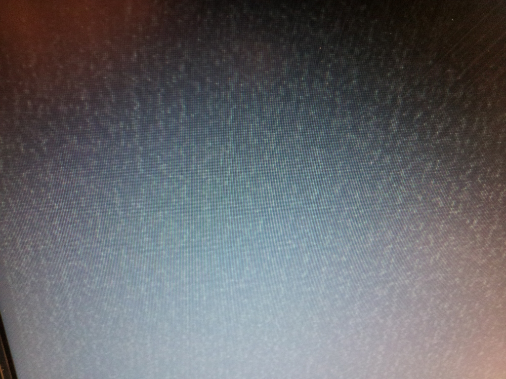

I've just tried bridging the ground plane. I used 5 wire links directly across the top of the TVP5146 from the analog GND to the Digital GND. I know its not as good as a solid ground plane connection but I would expect to see some improvement. The fact is - it did not make any difference at all !
I've attached an image of the noise I'm getting. Apologies for the very poor photo but the screen was just reflecting the camera unless i tilted it down. This is the screen I get when I completely close the iris on the camera, ie this is my background noise. You can see it has some structure of vertical lines so its not just random analog noise. By the way, the camera was also tested on my previous board and its not giving this problem on that board so I am assuming its not the camera that's producing the noise.

I'm having trouble determining what the traces are that cross over the split in the ground plane. If these signals are not static they will induce ground currents who knows where. It's a really bad idea to pass any signals across a split ground plane as there isn't a return path anywhere nearby. You're return path in these situations will become the path of least resistance for the electorns, which is usually an undesirable path back.
You might also be seeing problems with return currents cutting through the power plane if that is the easiest route back. The split up power plane might be contributing to the problem if the reference plane for the signals passing across the splits is the split power plane layer.

Another observation on the "bluish" power plane picture. There is a series of parallel lines running across the top of the picture. That look to be tapped off in the middle of the trace between two destinations. Unless all these lines are static or nearly static you're signal integrity may suffer if they have the typical sub ns rise times of today's FPGAs. The long stub will result in reflections that will degrade your signals. Do you have access to a TDR to test these traces? You would probably be better off using fly-by routing as it will present a smaller discontinuity on the transmission line.
Regards
Was this board routed with an auto router?
Most of the good board designers (they mostly hand route boards) would not place vias like a fence across large stretches of the board like this:
This set of vias basically makes a large slot in the ground plane which means return currents have to go around the slot. The ground plane in this design is covered with these ground plane "slots".

The board stack up is Red is Top copper; Brown is Ground Plane; Greeny-Blue is Power plane; Blue is bottom copper
I see your point about the signals crossing over the ground plane split. I assume you are talking about the three vertical blue tracks. These are actually SDA, SCL, and RST for the TVP5146. And although i agree with your point i do not think these will be responsible for the noise. The SDA, SCL lines are only used once at start up to configure the device, after that they are static. Also the RST signal is only asserted at start up.
All the VI_#_ABC inputs are grounded. Thats the bank of 8 resistors and capacitors to the top right of the TVP5146.

Regarding the inputs - I am using two inputs, Luma and Chroma. The other 8 inputs are connected to ground through 100nF capacitors and 75R resistors. I know the resistors are surplus to requirement.
On the input to the Luma I have the recommended anti alias filter a 75R termination and then 100nF ac coupling capacaitor. Exactly as shown on the evaluation module. See my schematic from earlier post
I understand how you've connected this and the tests you've performed up to now.
What I'm suggesting is shown in the following diagram. Leave the camera connected to both C_IN and Y_IN.
I think it might be helpful to know if the noise is injected into the design between the cap and the TVP5146 or it's actually coming in before the cap. If Test 1 still has noise then the noise has to be coupling in after the cap, which means test 2 should have similar results to disconnecting Y_IN.

Are you absolutely sure you don't have Chroma noise too?
https://forum.doom9.org/archive/index.php/t-159586.html
The fourth post has this to say about noise on the inputs..
So if you have noise in the Luminance, the picture looks noisy in a grayish way, like an old black and white move.
If you have noise in the Chroma, then the color looks unstable like an old VHS tape.
The noise in the luma is pretty much spot on. So are you seeing the color problems? Take a look at the thread on that doom9 site there are a couple of links to I guess some videos of noisy chroma.
