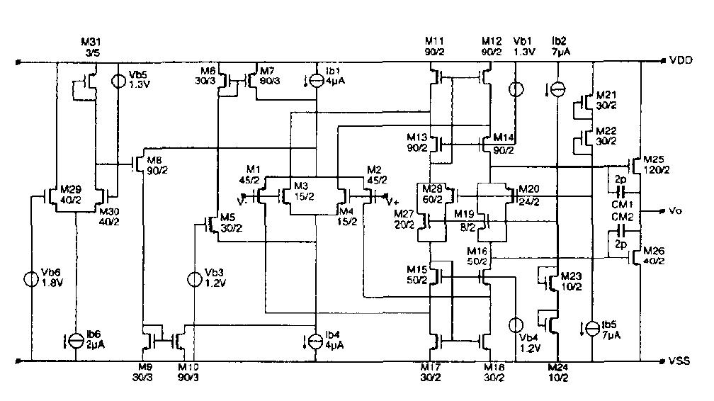

one more question is how i can make low output resistance rail to rail amp.
1. Voltage follower for output buffer is good output stage. but it have voltage headroom due to stacked mos.
2. common source with negative shunt feedback is also diffcult to use for rail to rail output stage.
Thank you.
Re: Opamp with big LOAD
You have to use some kind of a common-source amplifier if you want rail to rail output. Look at Philip Allen's book CMOS analog circuit design - there is a chapter on buffered opamps there.
It seems negative shunt feedback is used in Allen's book (buffered OPs). Could I think the method is to push P2(output pole) higher to A1*Gm/CL, and then make loop stable, especially for larger CL?
I met the similar problem, use the structure as below, while loads with 0.1uF Cl.
Any other choice? Thanks
