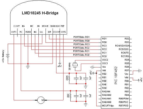

im always come out with errors using this C language coding for my pic18f452.....
can you help me to correct the errors....

The PIC is connected to the Motor Controller via 6 pins
PIN #1
PORTD Bit 0 - Used For Brake
PORTDbits.RC0
PIN#2
PORTD Bit 1 - User For Direction
PORTDbits.RC1
PINS#3-6
PORTC Bit 0 - Used For M1
PORTCbits.RC0
PORTC Bit 1 - Used For M2
PORTCbits.RC1
PORTC Bit 2 - Used For M3
PORTCbits.RC2
PORTCBit 3 - Used For M4
PORTCbits.RC3

This coding actually to run a dc motor clockwise and counterclockwise....and also to control the speed....
I receive error for this line...PORTDbits
mentioned 'undeclared identifier'....
and also error for this line...#include <delays.h>

I encountered error as mentioned below:
line 108 ; expected, but '' found
line 109 '}' expected '' found
line 109 Invalid expression
Can you help me with this?
This will be very helpful....Thank you

Can I know what does this coding will do if i connect it to dc motor? Btw i am using mikroC PRO for PIC compiler. I am using pic18f452 with a LMD18245 H-bridge connection and a dc motor.
