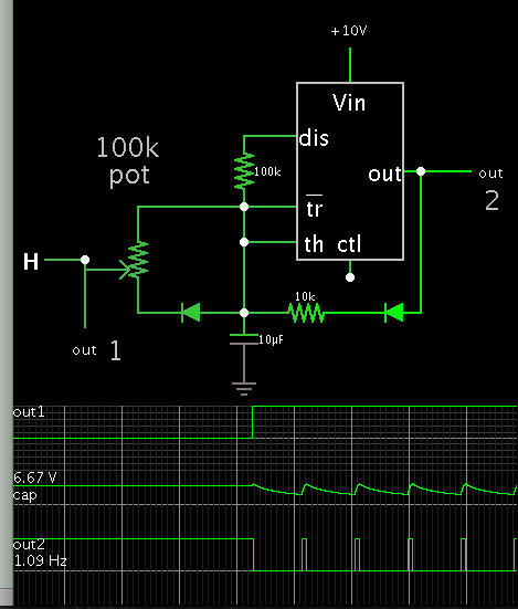

The retry stage can consist of a 555 IC, configured to send low duty cycle pulses.
The simulation shows it entering this state when the input (lefthand) goes high. This signal can come from a current monitor at your load.
There is a hurdle because you'll need some logic circuit that permits the input to go low again only during a retry event, and only if current is less than 10A. A solution could be a memory circuit such as an RS flip flop.
