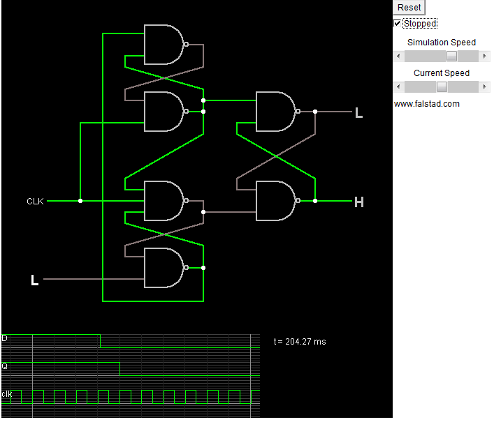

Basic difference between the two is that flip flops are edge sensitive whereas latches are level sensitive. So an edge triggered flip flop can be implemented using Nand latch as following

Can you explain your point? How this will work as latch if the clock is constant, I said this is edge triggered flip flop.

The link below is to an interactive animated simulation of the Edge-Triggered D Flip-Flop shown in post #4.
The website has some more flip-flops (as well as an entire library of circuits).
Click 'OK' when a window comes up asking if you want to load the java applet.
https://www.falstad.com/circuit/e-edgedff.html

Can you verify your point using the application shared by BradtheRad?

This will do. Only thing to be remembered is the clock signal must be a pulse input with continuos 1->0->1 transitions. If it is a constant 1 it functions as a latch i.e level sensitive.
Sorry, I wanted you to prove this point of yours, so if you make freq of clock 0MHz then will it become latch? That's absolutely wrong.
