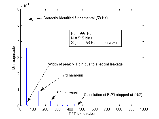

Hi all!use FFT can measure square wave frequency ? Or only measured sinwave.?
Square wave will give many harmonics and leakage. For square wave simpler method will give better result, something like period histogram.
Hi guys!
Aye - as Terminator3 said, there are a handful of other (easy) techniques for frequency measurement you can use. Don't despair if you're only using the DFT approach though - it'll cope with any waveshape (sine/square/triangle/mixture etc) you throw at it and simply report the frequency of the dominant component. To illustrate this, I fed the routines listed above a square wave of a specified frequency...
(which I created by generating a sinusoid in the same fashion as you did hluyen, and then "squaring it up" by:

Plotting the magnitude of the computed DFT bins shows the expected odd harmonics of a square wave:
...but most importantly shows that the frequency was correctly estimated. Note that I (randomly) selected some horrible Fs/N/Fsig parameters to ensure there were no "friendly" integer/harmonic relationships between them in order to exaggerate the effects of spectral leakage (which is pretty minor in this example, and won't hurt the accuracy of your frequency estimates anyway [finite frequency bin width is the limiting factor]).
