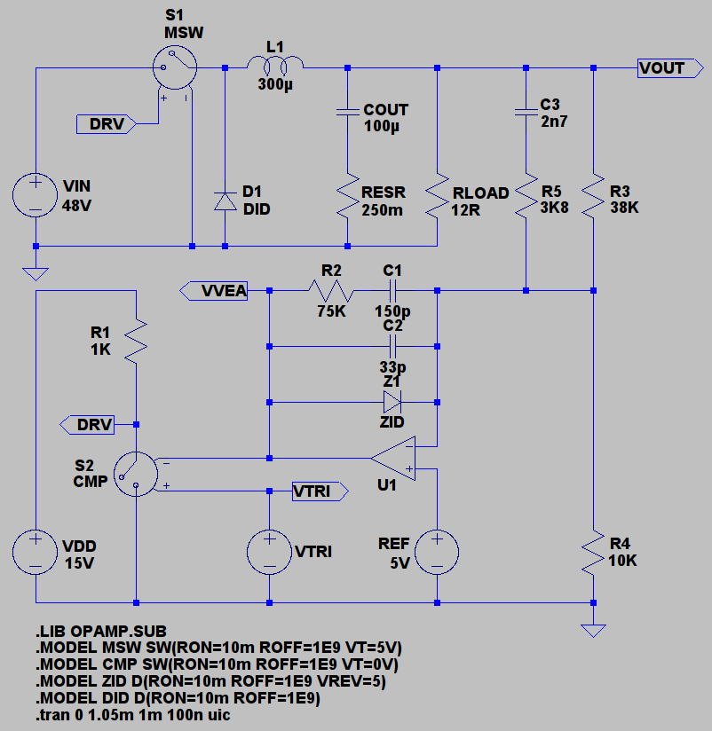

Let's say you are just using voltage mode control on a basic buck circuit. The end result will look something like this,
There are 'fundamental' limits to the amount of bandwidth you can get out of any particular buck configuration. Those limits give you the chance to design the loop in a simple way with some precision and derive from the concept of slope matching..
Consider when your switch is off then the output inductor is being reset through VOUT. Its current ramps down at a rate of LOUT/VOUT. That current ramp is converted to a voltage ramp across the output capacitor ESR and appears as ripple voltage on the output.
If the ESR zero is low enough, and for reasonable switching frequencies and low ESR electrolytic capacitors, or worse, it will be, then when your loop crosses over it is effectively a first order LR circuit on its own and will be so up to the switching frequency. That means, if you did not care about precision you could use a zero order amplifier and things would be stable.

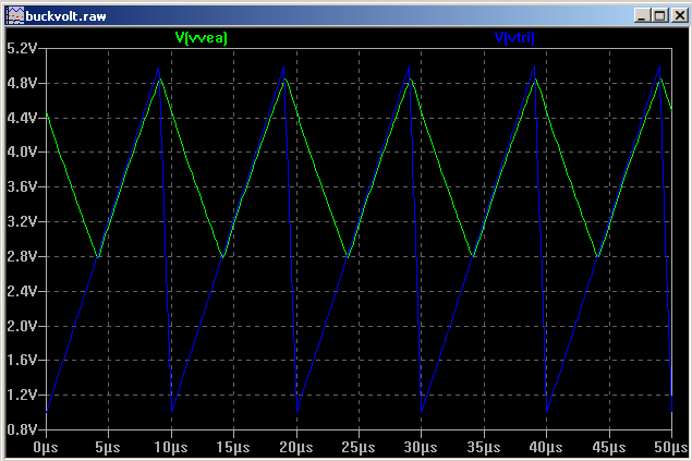

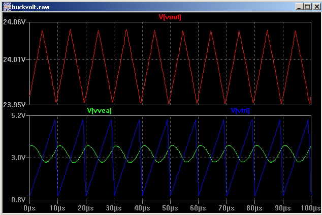

The gain at the switching frequency is limited by the slope matching criterion. If the slope at the output of the error amplifier exceed the associated slope of the PWM triangle ramp voltage then you will get 'subharmonic oscillation'.
In the above circuit my triangle wave swings through 4V in 9uS, switching frequency is 100KHz. This gives me a slope of 440,000 V/s. My 300uH choke is reset through 24V giving 80,000A/s which gets converted to 20,000V/s across the output capacitor ESR of 250mR. That gives me the maximum gain through the error amplifier at the switching frequency as being 440,000/20,000 or 22.
In the above circuit that is ultimately set by R5 and R2. If I set C2 to 1p and run an analysis then I get,
You will see that the slopes are, more or less, matched. If you tried to increase the gain in the error amplifier and the upslope on its output exceeded that on the oscillator ramp then having turned off the switch it would be turned on again, and then off, and then on and.... There would be a blur of switching.
If you had a latching modulator then this would not occur but you would get 'subharmonic oscillation'. At best that would involve unequal pulse by pulse pulse widths. It is this that sets the maximum gain in your error amplifier at the switching frequency and then allows you to move on and determine the rest of the compensation components.

OK. Having set things up for slope matching then with a DC path around the error amplifier we get no DC precision at the output. At the moment the circuit is 'nominally' first order and stable at crossover. If we want DC precision then we have to break that path, in this case with C1. That will make the circuit second order below the C1/R2 zero frequency which we place at half the 'known' crossover frequency.
Given VIN = 48V and VOUT = 24V then D is 0.5 and with Fs at 100KHz then fco is about 32KHz. That places the zero at 16KHz so, with R2 at 75K, C1 becomes 132pF and I'll use 150pF.... I can see I've made some whoopsies whilst playing so I'll correct the original circuit diagram. Cough.
Then I add C2. Ideally it is just there for 'noise' suppression but otherwise introduces another pole at about twice the previously calculated crossover frequency. In this case I have used 33pF.
Ignoring the other feedback components on the input the loop is second order up to about 16KHz then first order through crossover at 32KHz up to 64KHz where it becomes second order again. Should be stable.

During start up the supply would/might try to run to 100% duty cycle placing an over-voltage the output. Soft start and other mechanisms may prevent this however including this network in the feedback input slows the rise time. C3 will make the loop first order beginning at the C3/R3 pole. Since it is in the input it becomes a loop zero. That gets cancelled at the C3/R5 zero which being in the input is a pole.
I'm sure I have confused myself now. Anyway, with everything now in place..

In regulation,
Slope matching is no longer apparent since C2 is introducing its pole and changing the VEA output waveform.

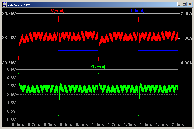

25%-75% load transient at 1KHz,

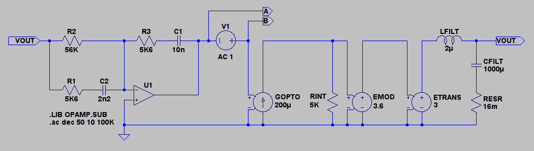

Have you considered setting up a linear model of the converter?
In LTSpice,
GOPT is the opto-coupler. Assuming a 1K input resistor and a current transfer ratio of 20% the value becomes 200uA/V. RINT is the internal pull-up resistor of the LM5025. GMOD is the Modulator/Power switch. With 18V in and 50% duty cycle limit with an internal 2.5V clamp its gain becomes 9/2.5 or 3.6. GTRANS is the transformer. 18V in with 6V out for a final 3V gives a gain of 3.
The circuits voltage feed forward will maintain GMOD against variations in input voltage.

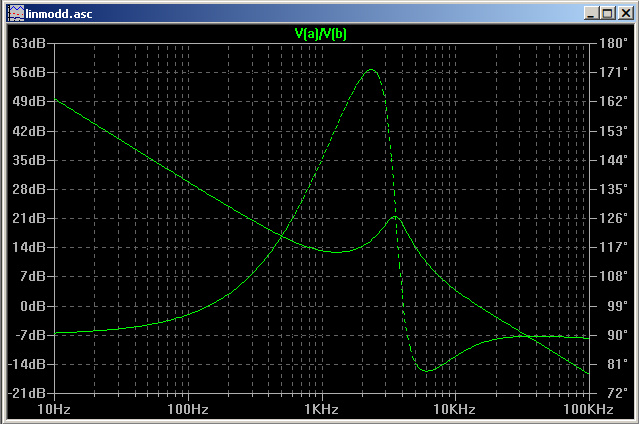

Then..... you run an AC analysis and plot V(a)/V(b) which will give you the loop gain of the circuit..
I have been guilty of fiddling with components to get that result but can explain further if you wish. One of the problems will be that you might target a specific crossover frequency but your filter capacitor ESR and opto-coupler will be subject to manufacturing tolerances and time/temperature variations.
Whilst you might hit your required 15KHz crossover frequency in theory in practice that will be subject to variations... That sort of makes my previous 'ideal' analysis almost worthless.
