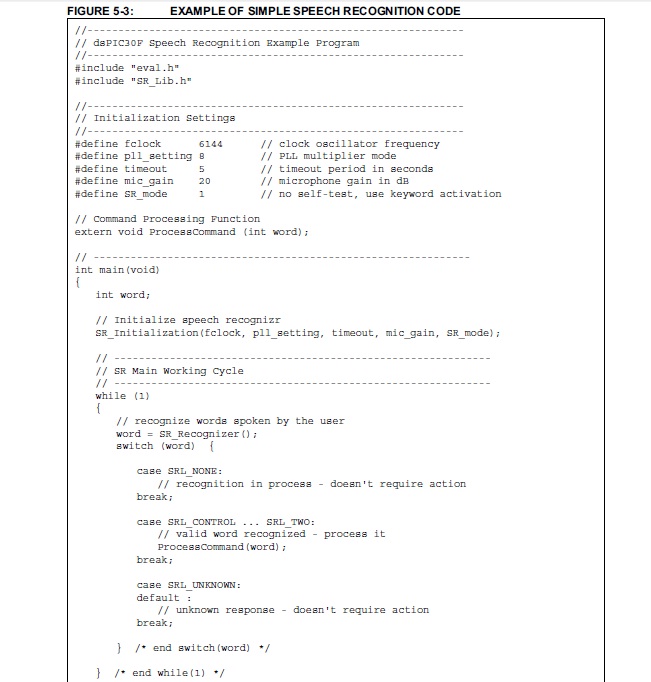

Thank you for your help. We have compiled the demo code on MPLAB IDE C30. Now, our new and main purpose is to make one of the output pin high whenever we recognized the some certain words that we set before like "yes" or "no". We make use of the example code given in dsPIC30F Speech Recognition Library user manual. We build our own word library which includes words such as "yes", "no". Then we tried to compile the code again in MPLAB IDE. We carefully followed your instructions also for this code but we have again the same error expressed in the first post we sent
SR_Lib.h:80: error: conflicting type qualifiers for 'WREG0'
C:/Program Files/Microchip/MPLAB C30/support/dsPIC30F/h/p30f6014A.h:50: error: previous declaration of 'WREG0' was here
SR_Lib.h:81: error: conflicting type qualifiers for 'WREG1'
C:/Program Files/Microchip/MPLAB C30/support/dsPIC30F/h/p30f6014A.h:51: error: previous declaration of 'WREG1' was here
SR_Lib.h:82: error: conflicting type qualifiers for 'WREG2'
C:/Program Files/Microchip/MPLAB C30/support/dsPIC30F/h/p30f6014A.h:52: error: previous declaration of 'WREG2' was here
We thought that this is due to the fact that we are writing also #include <p30f6014A.h> in c source code while following your instructions in the same time.
Because after we removed that statement from the code, we get rid of above errors. However, this time we get the following error which is related to making one of the output pins high.

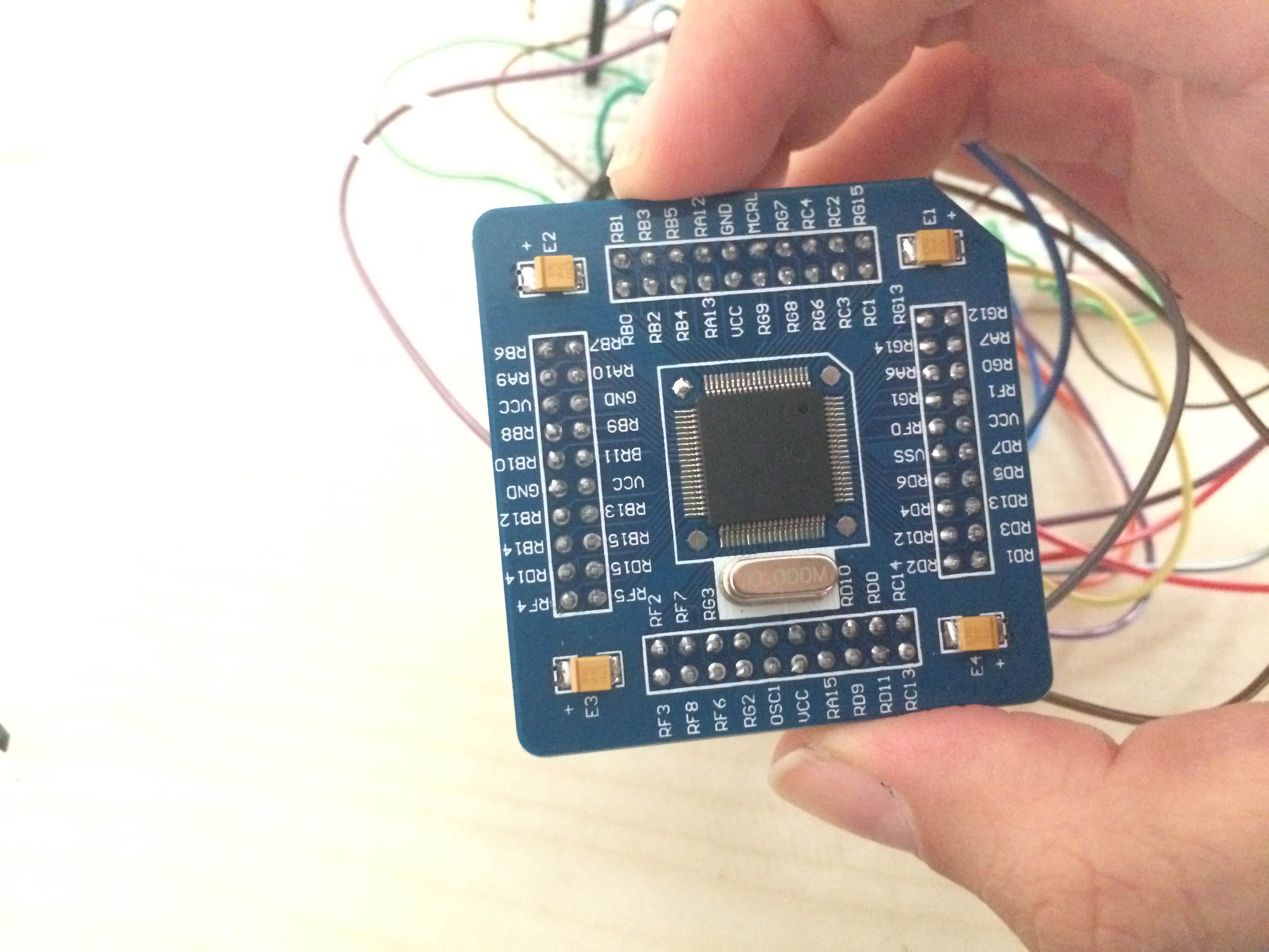

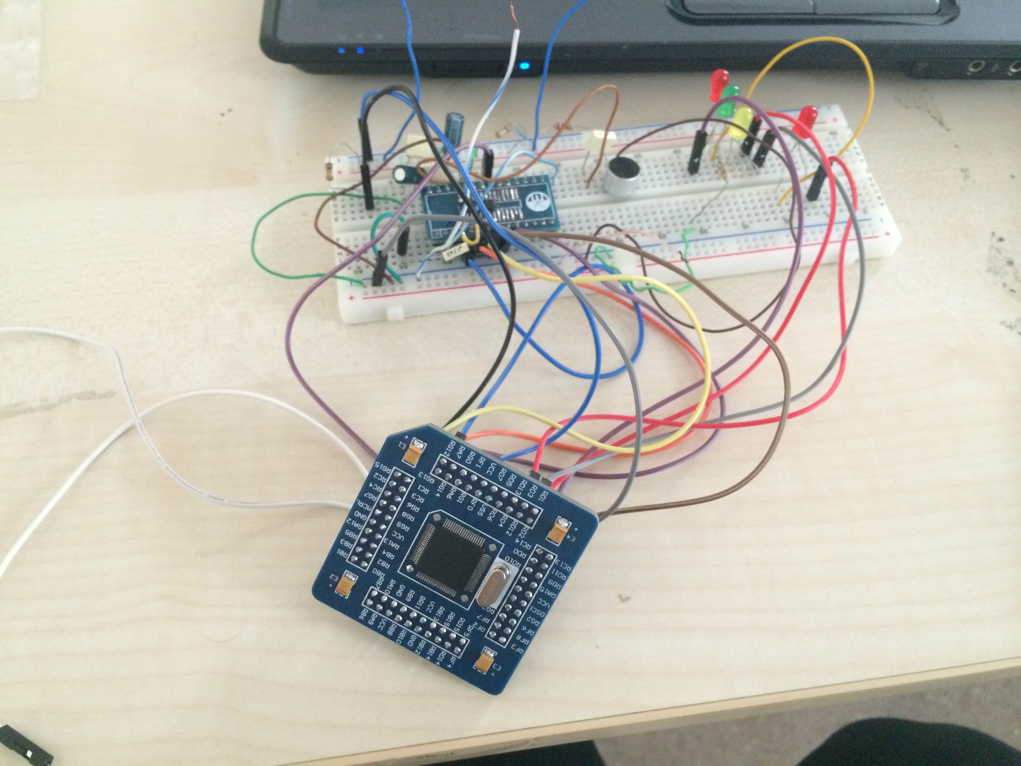

As we mention earlier our main goal is to make one of the output pin of the dspic high, we the desired word is recognized by the processor using speech recognition library.
Could you please help us on that regard? It is very important for us to implement this code.
P.S. We do not have dsPICDEM evaluation board. We have only dsPIC30F6014 processor (with 10MHz Crystal) and si3000 audio codec.
We attached some photos showing our hardware parts and example code.
https://obrazki.elektroda.pl/7780611400_1398380127.jpg
https://obrazki.elektroda.pl/2144382900_1398380128.jpg
https://obrazki.elektroda.pl/2670449100_1398380130.jpg
