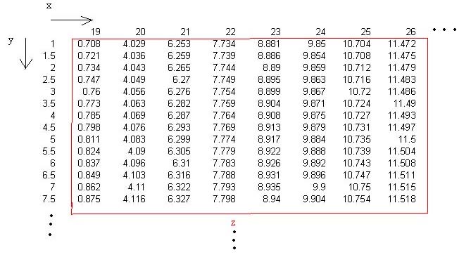

drawing a 3D(mesh or surface) diagram in MATLAB
perado
Full Member level 2
May 28, 2010
127
2,134
hello, I have data like the photo that I attached and I want to draw a surface with this data in MATLAB , but I dont know how I should write the program in command window, please help me
A good start would be surf(my_matrix) command. Then you can go further by finding commands to modify axis labels, ticks and other properties.
Hi Perado
This is Simple you have an x axis and a y axis right
x = [val1 val2 etc..]
y = [val1 val2 etc..]
[X Y] = meshgrid(x,y)
Input_Matrix = [ row1 ; row2 ; etc..]
mesh(X,Y,Input_Matrix)
Thanks,
Omar
Reactions: perado
    perado
Hi Omar, thanks
your suggestion be very helpful but now I have a problem that is an error when I import the Input_Matrix from excel (beacuse I have data in excel format, a matrix with 36 column and 4000 row).
what I should do to troubleshoot??
