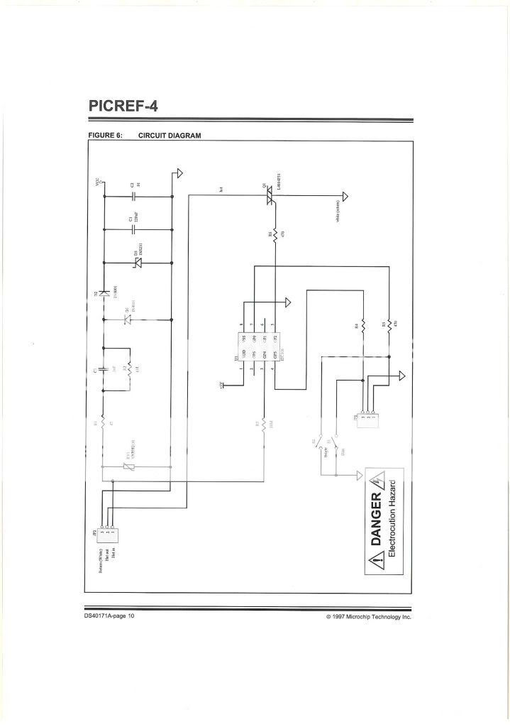

i am making a dimmer circuit
and i find a source on it in microchip
https://ww1.microchip.com/downloads/en/AppNotes/40171a.pdf
however the circuit have a R2 (1M ohm) in series with the power line
i wonder then how many current can be drive ???
as i connected the same circuit(with other atmel MCU) , the 1M have limited the current .....
so how does it work ??( i assume the Vcc = 5V in the circuit)
sorry the pic is uprighted..
and i search on the web which other circuit also have such 1M resistor

The application notes tells you that the maximum load will be 100W.
R2 acts as a drop for the zener to regulate at 5V. The Vcc is connected to the Vdd of the chip. Thus having a supply of 5V.
The load is connected to the Hot in and Hot out of JP2. Return of JP2 is actually the ground level of the circuit.
JP1 is only for the connector of the bright and dim switch.
