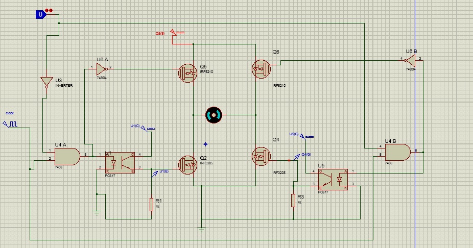

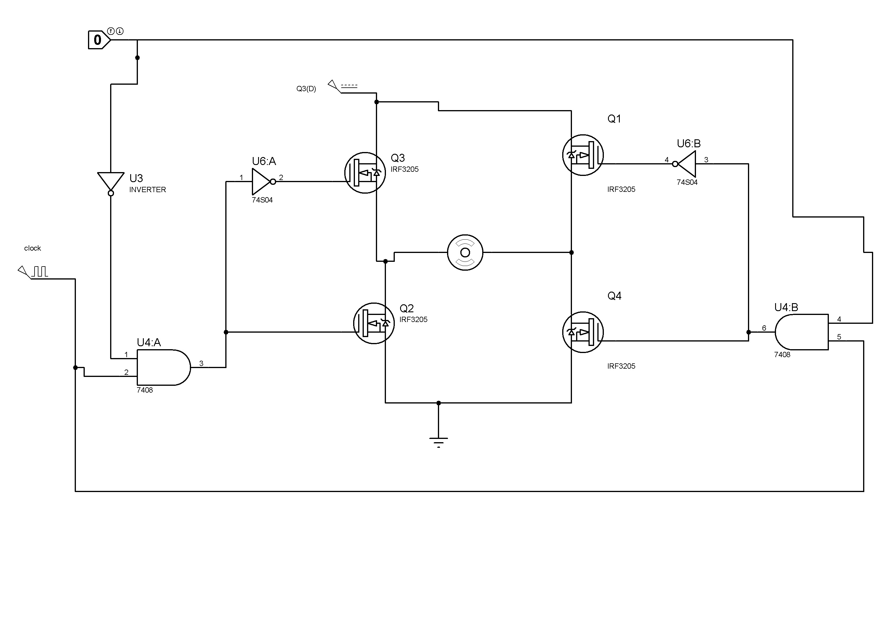

I am trying to do Dc motor driver with single direction pin (forward / reverse). I simulated it on proteus but the motor is very slow with high frequency PWM(clock). when i decrease its frequency the motor speed is increased. what is the problem in this circuit is it the components?
The mosfets need to be driven so they turn on fully. To do this you must apply a sufficiently high voltage to the gates (since your mosfets are N type). This is easier to do for N devices at the low side. However the upper Nmos may be difficult to drive so they turn on fully. Can you verify what voltage their gates are getting?
It may be easier if you use Pmos at the high side.
Nice circuit design, I haven't seen that control of the bridge FETs using AND and NOT before, I like the method, thanks.
Is it possible that the higher frequency lowers the clock signal voltage, and that causes the signal to the AND gates to fall into the grey area, or possibly not be enough to generate a strong high signal, if you understand what I'm attempting to describe.
Maybe not the problem, but perhaps measuring input and output voltages on logic devices and on NMOS device gates is one place to start troubleshooting.

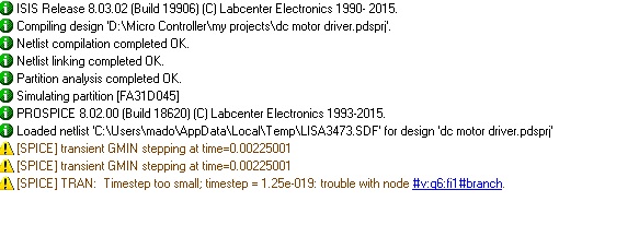

I used optocoupler with N mosfet to give VGs on and I used p mosfet with the high side. it runs for seconds and the simulation stopped
* Try changing the timestep to a larger amount.
* To turn off the P devices, the gate needs a voltage at the same level as its more positive terminal. It will help if you add pullup resistors (similar to the pulldown resistors you added to the N devices).
You need to make sure that each mosfet turns fully off and fully on. Construct basic test simulations, so you can discover the operating characteristics of the mosfet.

You have the Ho and Lo of U2 transposed.
To get forward/reverse you need to switch between one pair of transistors. That can be either upper pair Q1 and Q3, or right hand side Q3 and Q4, it really does not matter which.
But one of the pair needs to be on, the other off all the time to select the direction.
Then you PWM lower pair Q2 and Q4 alternately, or left hand side Q1 and Q2 alternately to get speed.
yes , I transposed it to work because it wasn't working on simulation.
now How to apply your proposal on the gate driver to control all the h bridge.?
Q1 = DIR AND PWM
Q3 = !DIR AND PWM
Q2 = !DIR
Q4 = DIR
(Edit: I changed the logic. Now the high side is PWM´d. Before the high side was only controlled with "almost static" DIR signal, but this created problems with bootstrap circuit)
