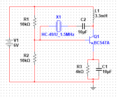

Can anyone point out what's wrong with this circuit ? I'm only getting a DC signal at the output.
This looks something like a Pierce oscillator circuit, but I think you need a small phase-shifting capacitor (about 100 pF) in parallel with R2.

@Kripacharya : Yes I know that simulation of crystal oscillators are difficult... that's why I used a sinewave function generator of 1.5 MHz, but the oscillations damped to zero as soon as I turned it off... I assembled the circuit on a breadboard and checked the output with a CRO, it is giving a DC voltage, nothing else.
@Tunelabguy : I tried with a 100pf capacitor across R2, it still gives the same output.
Who designed the circuit?
How do you saying this circuit will work for 1.5 MHz?
Do you have any design reference?
How did you choose 10uF on feedback, Did you starting trial and error method?
Do you know the working principle of the oscillator - and did you design it according to the oscillation criterion (Barkhausen)?
Did you consider the dampuing properties of R1||R2=5kohms?
If you design your circuit with the correct values, it will simulate. The problem with crystal oscillator circuits is that you need a small-time step and a lengthy oscillation time due to the slow built-up of oscillations caused by the very high Q of the crystal.
The 22 pF capacitor can be a trimmer to make slight frequency corrections.

Your circuit as originally posted certainly has some unusual component selections, and I noticed that though it does oscillate, it dies down very quickly. E-design's circuit is different from yours, and is a Colpitts variation.
For your own circuit, here's what seems to work :
1) Connect a new capacitor of value 385pF from collector to ground.
2) Change your inductor to 30uH.
These two then form an LC tank which helps store energy & sustain oscillations. You can use any combination of L & C which satisfy the resonance formula, but try keep the reactance somewhere in the range 100 - 300 ohms.

@Kripacharya : What I built is a pierce crystal oscillator, and going through the schematics, I found there using a FET, but also states that the FET can be replaced by a BJT. So why doesn't it work ? I want to know how to find out the gain of the feedback circuit.
If you use a pierce configuration you must ensure that you have enough phase shift around the loop to satisfy oscillation criteria. While you're working with a design, it is often better to use a crystal equivalent circuit with a lower Q that will allow oscillations to start more quickly during simulations.
The attachment shows the crystal equivalent block and circuit for this pierce design. Components R2,3,5 and C2,3 together with the crystal help to ensure that there is enough phase shift around the loop to allow oscillator action.

That 5Kohm base node impedance isn't helping any. The
crystal wants as high a Q as possible and for the input this
means high DC impedance.

With the pierce circuit the crystal operates in series mode and having equivalent series load resistance lower than the internal Rs of the crystal actually aids in short term frequency stability. Many high stability pierce designs aim to get the series load resistance below 15% of the crystal internal Rs value. By doing so you obtain in-circuit Q values that approach the Q of the crystal and much improved short term frequency stability.
With crystals operating in parallel mode you don't want loading and hence low frequency crystal oscillators with a high internal crystal Rs need a jfet or something similar to prevent loading that will impede start-up and frequency stability.
That 5 Kohm base node impedance isn't helping any. The crystal wants as high a Q as possible and for the input this means high DC impedance.
The base node impedance is even lower because the common emitter circuit input is connected in parallel.
But that's not the reason why the original circuit isn't working. The reason has been shown by E-design and others. It's the lack of external capacitors that are necessary to shift the inverted phase of the CE amplifier towards 0° to fulfill the oscillation condition. If you place e.g. 100 pF capacitors to ground at collector and base node, the original circuit is oscillating.
For clarification we should know the LCR parameterss of the Multisim crystal model, but I guess it's not too far away from the said "lossy" model by E-design.

Okay let's just get down to the basics. We know that for oscillations, a positive feedback is required. So this can the achived by using a feedback circuit that shifts the phase of the signal by 180°. So the Amplifier gives an 180° shift, and the feedback circuit gives 180° shift... So, total phase shift 360°, the circuit oscillate, right ?
Here, the transistor is giving 180° shift, and the crystal is giving 180°, so why the oscillations not sustaining ? Why we need the two capacitors to shift the phase to 0° when we need 360° ?
Here, the transistor is giving 180° shift, and the crystal is giving 180°,..
It is not true that the crystal gives 180 deg. phase shift. The phase shift depends on how close the frequency is to the series resonant frequency and what other circuit components there are. The capacitor that was omitted from the original circuit is necessary to make that phase shift come out to 180 degrees. Without it you never get to 180.
At series resonance a xtal looks like a few hundred ohms. Above resonance it looks like an inductor whose reactance is Q X few hundred ohms, err, 100 X 50,000, or or very large value. So just connecting a xtal from base to collector is like connecting 200 ohms, would it oscillate?, I think not. So you need some capacity between base and earth to give the 180 degrees of phase shift to get it to oscillate. If you also connect a smaller capacitor from collector to earth, you have also got a PI network to better power match the voltage at the collector to the base, so you get lower losses.
Frank
P.S. the 10 MF in series with the xtal is tooooo big, try 1000PF
I thought the 10 uF was to block DC, does it have any other applications also ?
