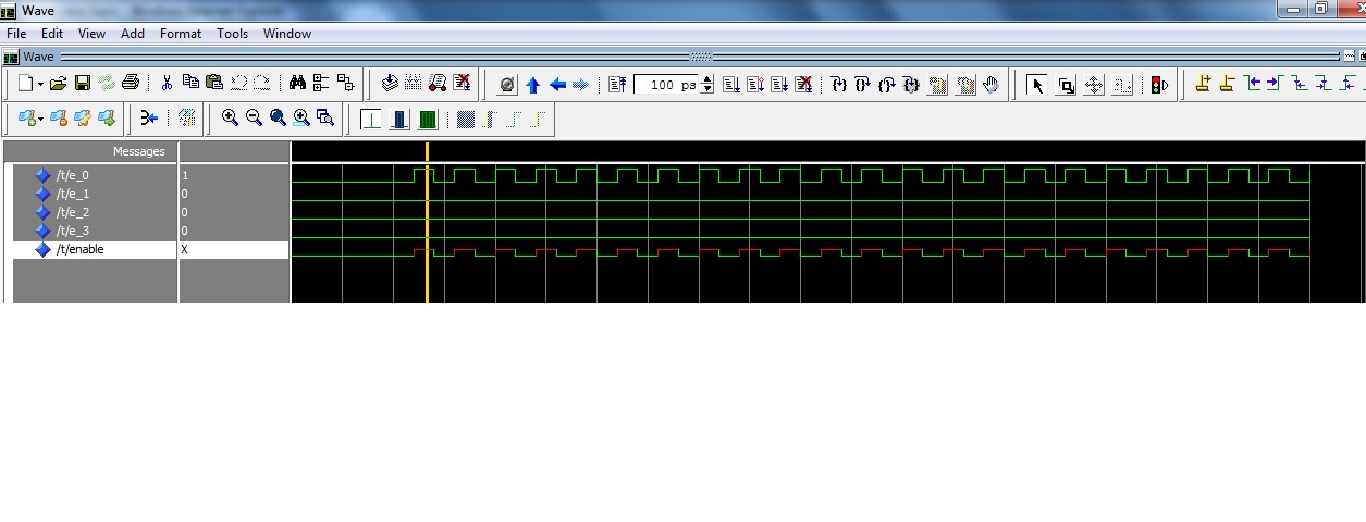

I am trying to implement a multiple input XNOR gate using the virtex II Pro unisim primitive BUTF. My VHDL code is as follows:

The code compiles fine, but when I simulate with Multisim, I get the output at shown in the attachment:
The Schematic:
Can anyone please tell me why I get the undefined output when one of the inputs is logic 1, and how to get the correct output.
