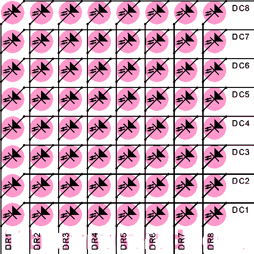

hello everyone, i would like to ask about the LED Dot matrix
i'm new to this device and this is a 5x7 dot matrix
Below showing the small part of the programming coding to display alphabets A to Z..
anyone can explain the logic on the coding to display a alphabet A?

Logic is multiplexing... You need to implement it by utilizing the property of our eye - ' persistence of vision'
Try this link, I hope you will get something...

well the image you attached explains everything. Anyway, check out my figure below which may explain the hex pattern for character 'A' on 5x7 led display.
//     Example font pattern for 'A'
//         {0x7e,0x09,0x09,0x09,0x7e} //A
//                    _________
//      PORTB.0  ->  |0|1|1|1|0| LSB
//      PORTB.1  ->  |1|0|0|0|1|
//      PORTB.2  ->  |1|0|0|0|1|
//      PORTB.3  ->  |1|0|0|0|1|
//      PORTB.4  ->  |1|1|1|1|1|
//      PORTB.5  ->  |1|0|0|0|1|
//      PORTB.6  ->  |1|0|0|0|1| MSB
bit 1 = LED on
only one column is enabled at a time.
first 0x7e is loaded into port and column 1 is enabled and rest off (see the first pattern in your figure)
then 0x09 is written to port and column 2 is enabled and rest column off (see the second pattern in your figure)
then 0x09 is written to port and column 3 is enabled and rest column off
then 0x09 is written to port and column 4 is enabled and rest column off
then 0x7e is written to port and column 5 is enabled and rest column off (see the fifth pattern)
now the above sequence is repeated very fast so we see all the column pattern combined (see the sixth pattern in your figure)
Result = character 'A' in 5x7 led matrix display!

Led matrix is the array of a group of LED . In which each LED can controlled
The above picture is an 8x8 LED matrix .Here we can control each LED by applying supply to any columns to row .(DR1 to DR8 - rows ) (DC1 to DC8- columns ).Display Technique Every displays take an disadvantage of our eyes lacks known as Persistence of visionThat is the display shows the data (ie the LED blinks) at a time (only rows or columns)By controlling the flow of electricity through each row and column pair it is possible to control each LED individually. By scanning across rows, quickly flashing the LEDs on and off, it is possible to create characters or pictures to display information to the user. The refresh rate is typically fast enough to prevent the human eye from detecting the flicker.
if don't you understand look at the picture below
LED matrix display scanning by rows to make the letter WHere the Row scans first as slowly .after it running speedily due to our Persistence of vision we can see as a letter W this is the technique .
