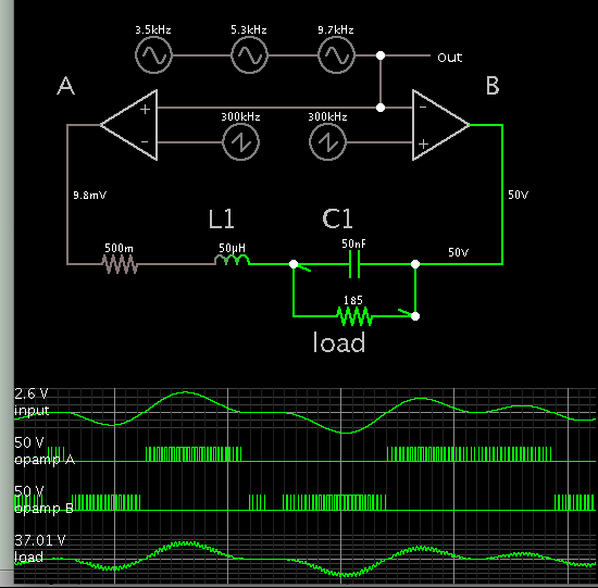

This simulation mimics a class D amplifier (using your specs). It should give an idea what L & C values to choose.
As you can see, L1 and C1 are just a bit smaller than they ought to be. They have a noticeable effect in smoothing the 300 kHz DC pulses.
As you reduce L1's value, the spikes get worse.
As you make L1 larger, it starts to 'choke' the output amplitude. It's hard to be sure what tradeoff point to choose.
C1 can be increased to reduce spikes, although this also causes it to carry more current. This may be of concern to your capacitor size.
This is a second order filter. There is a formula for calculating the values. However the simulator makes it easy to see the effects of different values.
You must watch for resonant action from the LC. Obviously it is best if you make sure the resonant frequency falls outside the frequency band being amplified.

Yes I get that, but can you use this arrangement for 3rd order ,5th order with this design. Does it have its own complications if you do?
i have been looking at stuff like this in LTspice but I am trying to see the best to simulate it, I will have a look at it in that software too to see what happens. Is there any way to get a higher order? Or any comments on the inductor design in terms of Isat?

From what I understand, DC pulses are the only thing that is applied to the output stage. The pulses provide a path to either 50V or 0V ground.
Distilled version of class D action. (Only the positive waveform is shown.)
a) Signal and carrier are compared by op amp, creates PWM output.
b) Op amp drives a switch.
c) The switch goes to either 50V, or 0V ground.
Is the signal seen by the left hand side on the inductor a 300Khz switched audio signal, as in isn't it basically the 300Khz signal being switched to produce the audio signal??? Below is the signal on the inductor
Isnt this why the LP filter is used to remove this 300KHz?
