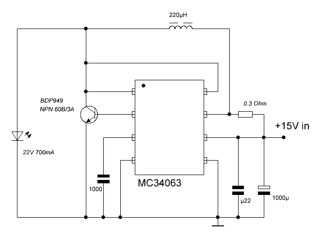

Hello.
I need to power a block of LEDs at ~23V and 700mA from a 15V source.
AFAIK, it means a boost converter and a current limiter in one circuit.
I tried to use a MC34063 with current sensing feedback like so:
It worked nicely for a grand total of 30 seconds, then the smoke found the way out of the IC. :(
Theoretically, it should have been just within limits - ~1.31A inductor current out of 1.5A supported.
So, can this design be made to work, or if not - how to do this properly?

Although you say it worked for 30 seconds...
Are you certain you drew the schematic correctly? It does not show a working boost converter (nor a buck-boost).
Anyway you say the IC overheated.
Did it receive a severe surge of current on power-up? Theoretically it could be several amperes.
I am running a simulation of a simple boost converter. Waveforms show an average of 0.7 A goes through the switching device (IC). This should not cause trouble for your IC at high switching frequency (continuous conduction mode).
However at a low frequency (discontinuous CM), the peaks will reach 2.4 A. If your IC does not have a low enough 'On'-resistance, then it will extend the On-time in an effort to pass sufficient current. If this gets out of hand, your IC could burn up.
I think so.
What appears to be drawn wrong?
The resistor on the low side of the LEDs gives a voltage drop proportional to the current, so at about 1.8ohm the feedback pin would see 1.25V it expects at 0.7A, and try to raise the voltage until it gets there.
There might be a problem with that, actually - there is no explicit upper limit on the voltage, so if the LEDs get disconnected or something fail open-circuit, it would keep on raising the voltage until something gives.

Circuit is not good, where you find that? How this survive 30sec, are you sure that this works at all?
Read IC datasheet for correct StepUp circuit.
Check calculations or use one of OnLine MC34063 calculators to check design. Ipeak should not be 1,5A or you should use external switcher transsitor/MOSfet.
MC34063
Pin 8 use 180R
Beween 7 and 6 use 0,22R

Here is what i ended up with, with external switch.
This one matches up the device, and was working for hours already.
That's what i did - took the step-up circuit from the datasheet, and tweaked it for constant current step-up.
