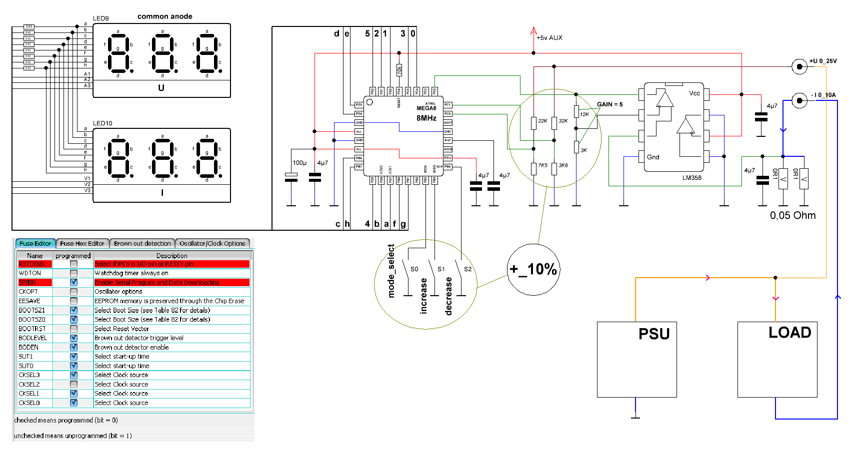

Another one digital voltmeter on Atmega8
next version, with current (0><10A) measurement channel.

thanks for your nice work. can you explain the functions of three switches? mode select, increase,decrease.and can we modify this circuit for higher current ratings and higher voltage.? like 230volt and 50 amp using 4 display with polarity
indication. i think it can be modified with using atmega 16. afterall keep posting this type of project
Hi.
it's for adjusting without divisors resistor selection, will allow to reduce or enlarge measurements results within 99 ADC points (from 1024).
Simple hold mode selection button, adjust first range of the voltmeter, once again hold and adjust second range, next hold - adjust ammetre channel, next - return to normal operation mode.
When see "L" - points will be subtracted, when "H" points will be added.
I can not (because have lack of time), but you can modify it yourself if you want.

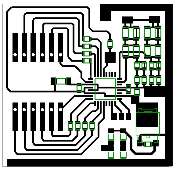

I wish to make this project but I have one problem: I can't see the pcb file.
Anybody help me ?
OK I undestand !
I supose the pcb file is vx2.dip .I can't open this file , *.dip extension is unknown for me.
