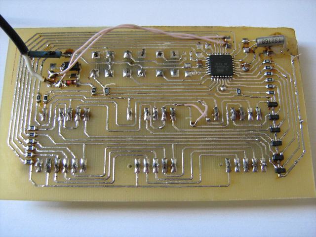

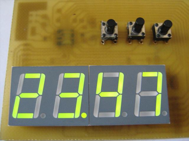

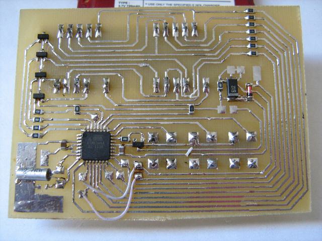

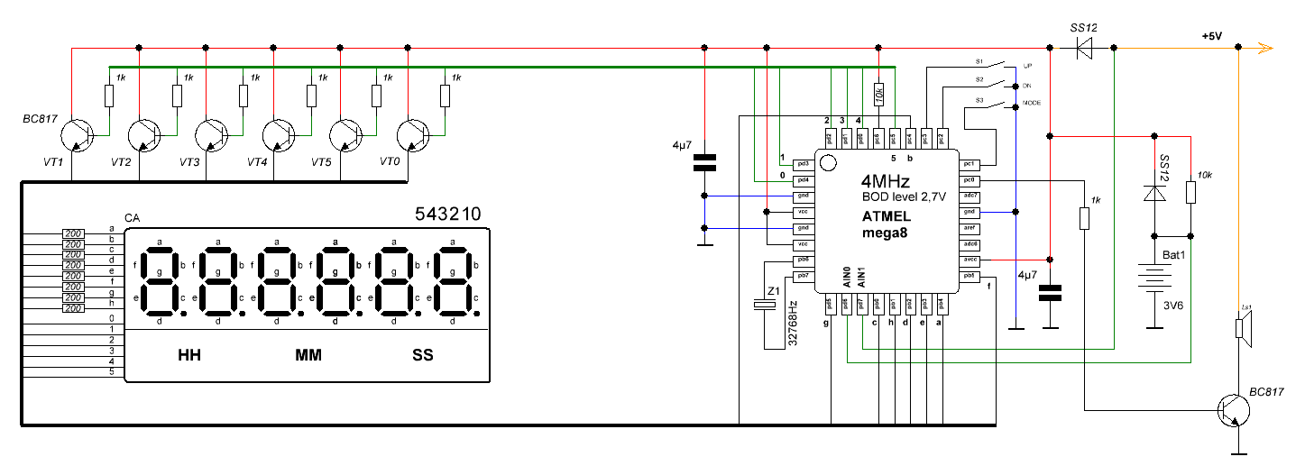

Another one digital clock on atmega8.
thanks Pradeep.g.belchada.

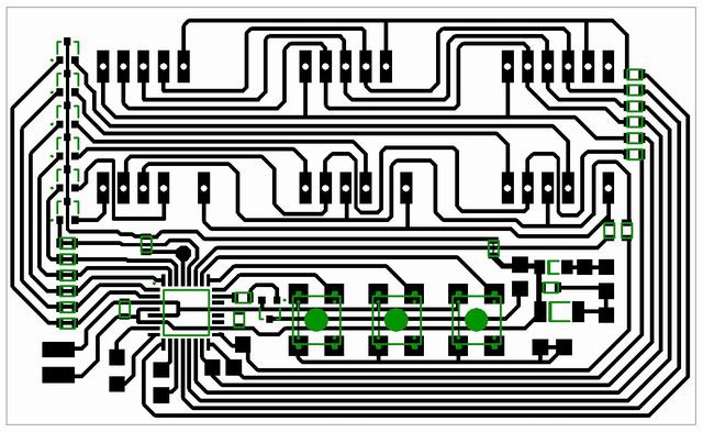

version with only four digits
  • cl4dgt c&hex&pcb.zip

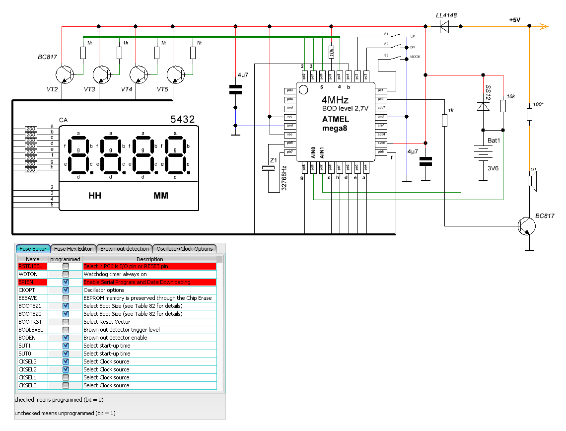

amended version (corrected in port D initialization and energy saving mode)
  • clock_m8_ec.zip
