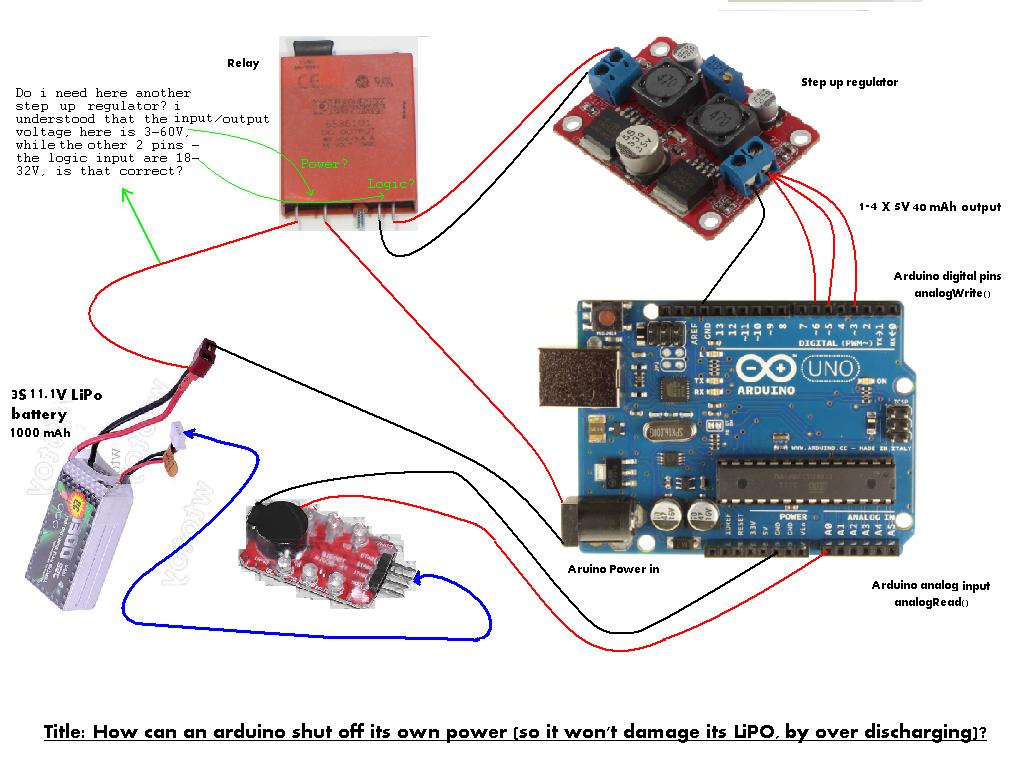

I am trying to build a circuit to protect my 1000-2000 mAh 2-3S LiPos, from over discharging. I am using also an Arduino uno and Low voltage LiPo alarm buzzers - and at the end point i have several small servos. I think that the problems with all these chips, is that although on the logic and analog side, they do exactly what i need, but they will not be able to stand such a current as the LiPos let out. So i started searching for relays - but relays that have DC voltage of around 3-20V, not only for logic, but also 3-20 V DC for load - are kind of rare and expensive. I found mostly relays that are manufactured by opto22 - but too pricy.
Do you have any idea for a solution?
Thanks.

I will try to make a block diagram of the system, in the meantime, i have several questions:
I would have used the Arduino sleep library - but the problem/advantage is that i have separated the servos power line from the Arduino - the servos get the voltage directly form another LiPo via a small regulator - for the sake of a better power distribution and also not to damage ultra-sound sensors reading that i have on the Arduino - it seems that when the sensors and the servos are connected both to the Arduino 5V output, every time the servos start working the sensors go buzzerk. As well, it seems to me in general that the Arduino can not let out enough current for the servos.
Basically what i did and maybe it was an error - is that i have purchased this relay:
Now, regarding this above relay i have a question:
I have this regulator:
If i have on one side of this regulator (input voltage) the Arduino Uno 5V 40mAh digital pin (PWM) output - Can i get on the output voltage side of this regulator, the 18V 9mAh input voltage logic signal needed for the above relay?

Re: Looking for an on/off digital toggle signal chip
Your question makes sense but I don't think your relay is going to work.
If I follow your connections, your Arduino produces a PWM output with maximum 40mA load, you want to step this up to 24V using the regulator board and use that to drive the relay. The reason I'm doubtful it will work is that you assume the Arduino will produce 5V *AT* 40mA load, it's more likely it will produce significantly less at maximum load current. You would have to set the PWM to 100% anyway to ensure a stable output. Even if the voltage did hold up, the maximum load power would be 5*0.04 = 200mW. The relay requires 24V at 9mA = 216mW so even if the regulator was 100% efficient it would still not provide enough output. In practice, you would expect around 75% efficiency from that kind of regulator when stepping up that much. So I won't say it will not work but I will say you are pushing your luck!
The CD4066 is an analog switch and it will not work properly in your application. The reason is that when 'on' the switch will have a DC resistance of around 250 Ohms. These are really intended a signal switches where the load after the switch is quite a high resistance compared to the switch itself, typically they are ('were' - they are old devices!) used as input selector switches in audio amplifiers. The specification limiting their input current to 10mA is because they drop so much voltage in their internal resistance that they would overheat if you tried to pass more.
What you need to explain is 'how do you know when the cells are over discharged?', you need some kind of voltage or charge monitoring system and it would be better to concentrate on that rather than the switch itself. For example, if you need to disconnect the load at a certain cell voltage, you can do it with a single transistor, zener diode, two resistors and a relay.

For LiPo discharge detection per cell, i am planning on using these LiPo alarm buzzers - while soldering a wire to the buzzer or led output ground and + and connecting it on the other side to the arduino analog input:

That should work but there is probably an easier way to do all this. The problems you may face are that wiring to an LED or the buzzer may not give you a 'good/bad' indication by simply measuring voltage, it depends upon how they are wired on the board. In any case, the difference between an LED being on and off may only be a small voltage change which you have to measure and compare with a threshold in your program. I think as simpler system would be a single transistor and relay circuit. The transistor drives the relay which in turn disconnects your cells. The transistor would be biased by current through a Zener diode with a knee voltage (Vz) about 0.6V less than the lowest cell voltage you can tolerate. When the voltage is above (Vz+ 0.6) the transistor turns the relay on, as it drops lower than that, it turns the relay off. It's only 5 components and much cheaper! The drawback to this simple method is that if you power the relay from the cells, as it turns off, the load on them reduces, their voltage goes up slightly and the relay might kick in again. You would probably have the same problem with the HobbyKing product as well. There are several ways around this, all relatively simple but does this approach sound reasonable to you before I explain more.

Here is the reason i went for these LiPo over-discharge buzzers and was discouraged from trying to measure the LiPos per cell, by building my own circuit, there is this guy who finds it very easy to check out 1 cell, using his Arduino and then, when trying to expand his idea to all the cells on his LiPo, things start getting kinda messy:
